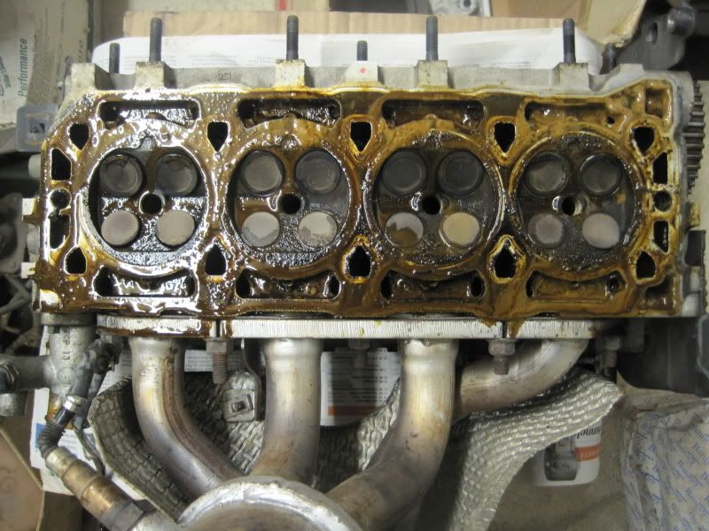

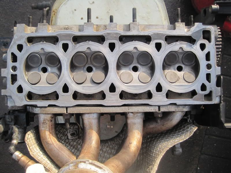

So this becomes this after treatment :~
Before :~
After :~
