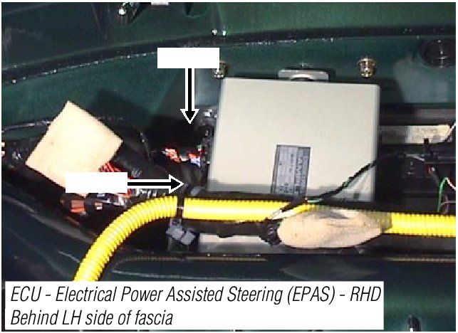

So, I have a question, well two actually. Did my car leave the factory without EPAS or has it been removed since it did that back in 1997? Also, I just happen to have a complete MGF EPAS Steering column. Will the 1997 non-EPAS car's loom have the necessary connections to enable me to fit that?
You have EPAS fuse in place. I would say that if you have EPAS ECU in place too, then you might have all necessary wiring loom in place too (MGF/TF EPAS):
