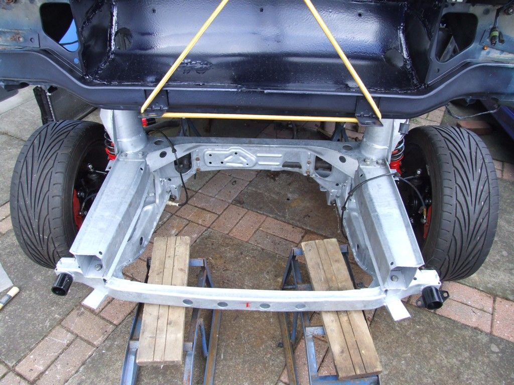

my attempt at rust treatment was shot blast subframe back to bare metal apply por 14 for the hard to reach areas and all the pitted areas , covered in zinc 42 then primered 3 coats and then 3 coats of red with 2 coats laquer on top , also did a few of the ancillery parts
i also did the engine bay and brake pipes all rust cleaned up and treated then sprayed up right to the middle underneath pipe cover , a lot of new parts , including clutch , gearbox rebuild , hg , belts , water pump, lotus front to rear clutch pipe, slave cylinder, nippled gear arm , 2 new handbrake cables 2 new top rear ball joints 2 new rear bottom arms and a few others ...total cost about ÂŁ800 so will last another few years
and a year on it still looks this clean
if you do it yourself shot blast frame cost around ÂŁ40
rust treatment ÂŁ15 but plenty left for other areas , paint about ÂŁ40.......time ...loads
