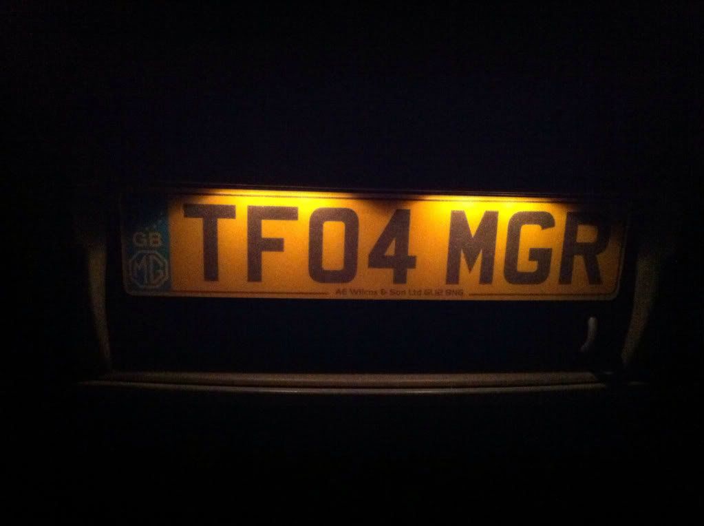

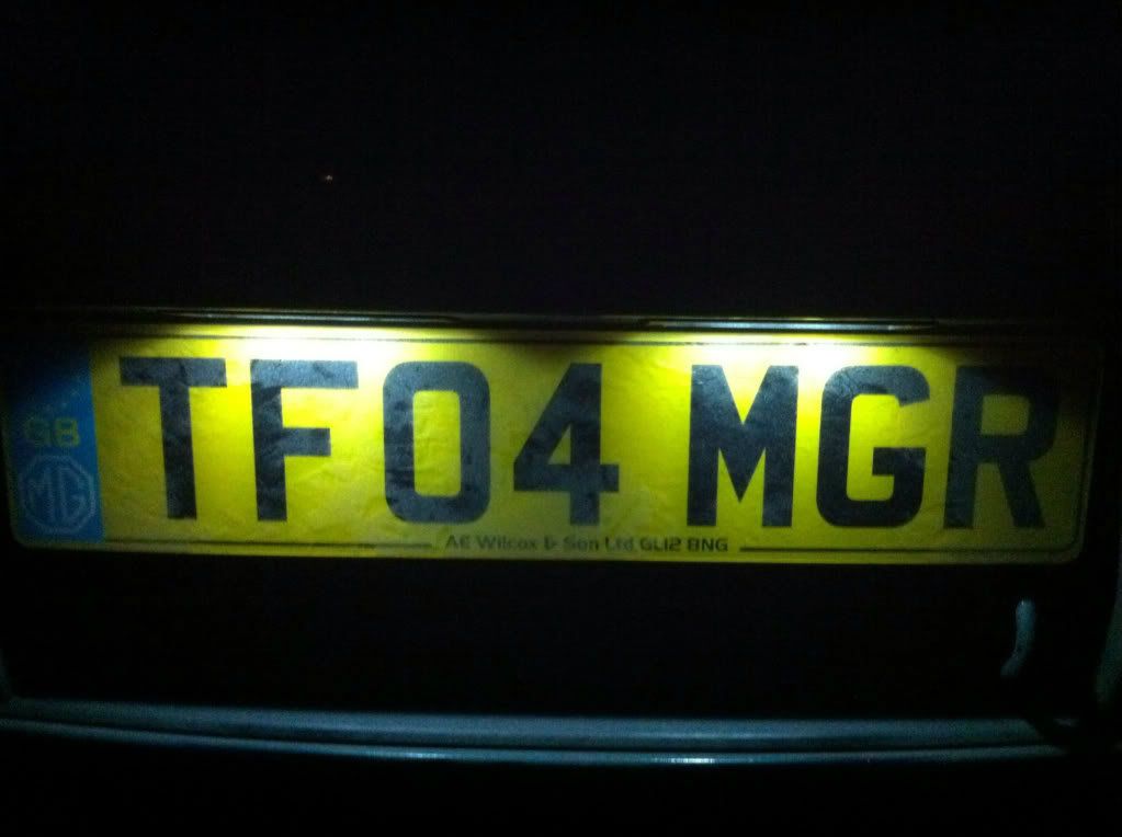

I also bought 2 LED festoon lamps off e-bay
and fitted them. They give a better white light and should last longer.
Remember, if fitting LED lamps they only work one way round, so if they don’t work, take them out, turn them around and refit them.
Also the led bits need to be turned in the direction you want the light to go. If you fit them upside down they won’t light the number plate very well.
