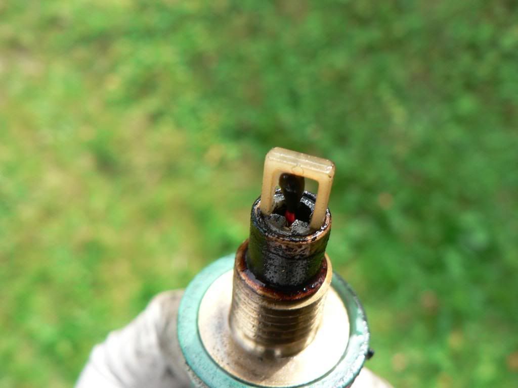

The inlet air temp sensor is easy to remove (once the engine hatch is off) and reasonably easy to test - it looks like this: http://i230.photobucket.com/albums/ee204/macleodaj/MG/P1020878.jpg
There's a thread about it here http://forums.mg-rover.org/showthread.php?t=363423 which gives the resistance at 24 degC to be 1.95 KOhms.
I gave mine a clean with servisol, no idea what's best or if that's harmful but a new sensor is cheap enough and there should be loads of them in scrapyards as the same sensor was quite widely used I believe.
