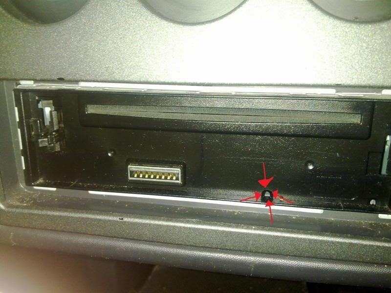

Anyway, just been out and when I took the headunit front off i noticed this red flashing LED hidden behind it like an immobiliser (but I also have the standard immoboliser in the car as well), any ideas what it is or does? (I have done a search on the headunit with no luck)

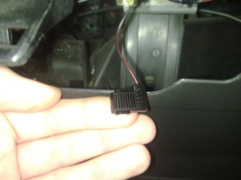

I found this cable end with connection block sticking out of the back of the glovebox and have no idea what it is
There is a microphone on the interior roof which runs through the passenger side trim - could it be for this?
Its the stereo saying its security is active. Its got nothing to do with the car's imobiliser. It cn be turned off through one of the menus. Kenwood's website (kenwood-electronics) has got a good library of PDF manuals.
That's the glovebox light switch.
