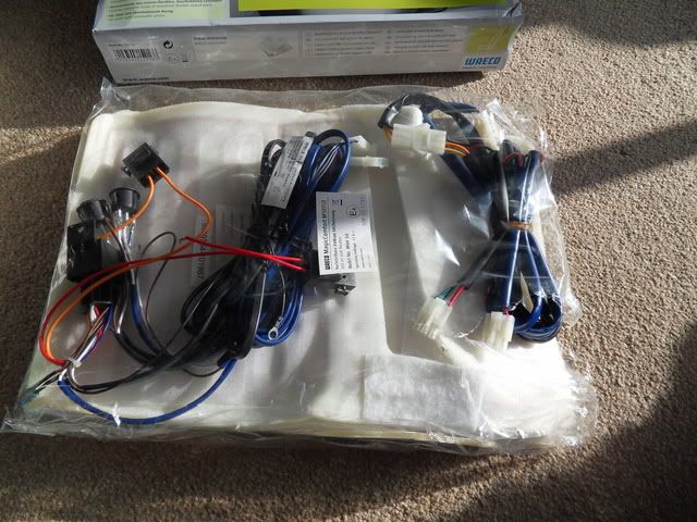

Got a parcel this morning - and no its not a body its this
The question now is , can i make them operate with the heated seat switches in the car and just leave the switches in the loom to control the heat setting ?

Why not have the 1-0-3 switches fitted to the side of the center console and use the OEM switches as a Master Power switch ?
Leave the kit ones on 2 so when you turn on the OEM switches it comes on but you have the option to turn them down, but like the circuit of a landing light swtich set up on a house. :broon:
