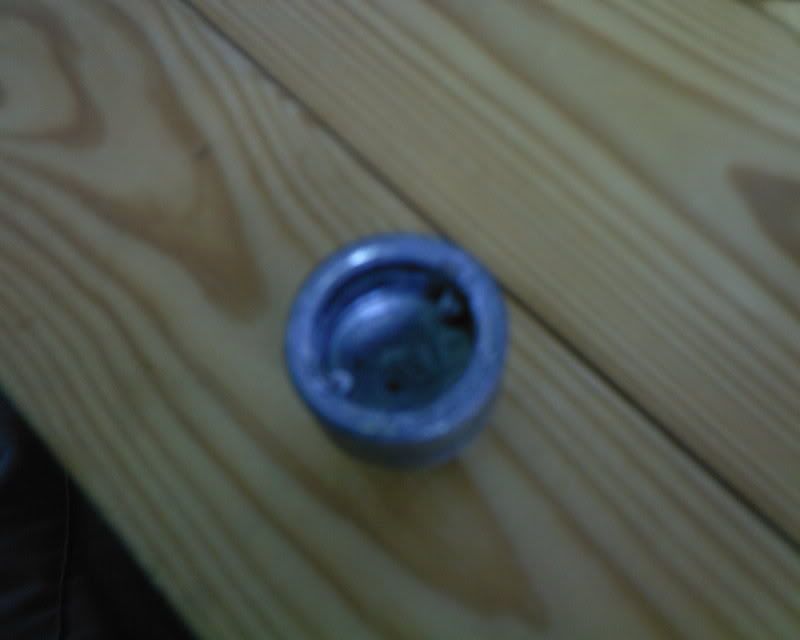

Anybody know were i can get replcement locking wheel nut key from? Just been out to have a tinker with my ti and the key decided to sheer the two little nipples off! It has 53 stamped on the top, that is the only ID on it.

They all have diffrent number on them but they are the same one. I have one the same that I took when we shut up shop and it's got 2 stamped in them. Most dealers had trouble ordering them even with the key number same as lock keys also. But if you decide to buy a new set from Rover as they dont sell them seprate then try and ask for a set 63 they are the older ones and have 6 side on them so plenty for the locking tool to grip. They used to fit them to the 800/Mk2 200/MK1 400 and the Metro a much better quality before the dark days of BMW.
But if you need it off do what has been said above whack a 6 sided socket on and it will come off. Make sure it's a damaged socket and not a best one as it will only be fit for scrap afterwards.

Hi guys, contiuing in the same vein I have sheered the two little lump bits off my locking wheel nut key after changing my front pads. I read throught the thread so Im gona try a local dealer tomorrow to get a replacement key (mine has 46 on the top) but if that doesnt work I did get a locking wheel nut remover socket but it was too big. If i need to by another set what size socket do I need ? Rover 200 1999 just incase that makes a difference.
