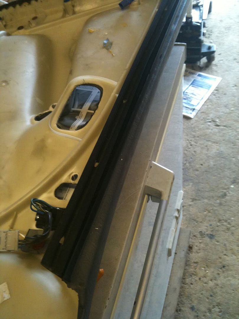

I've managed to break off the piece of metal that the window runs up. It's attached to the card by what appears to be some gluey plaster stuff. What can I use to stick it back on? Super glue doesn't work.

Myn arent stuck on either, must have been broken in the past and fixed! Looks like where it slots the bottom bit has come off, as there is just slots/gaps, no holes!

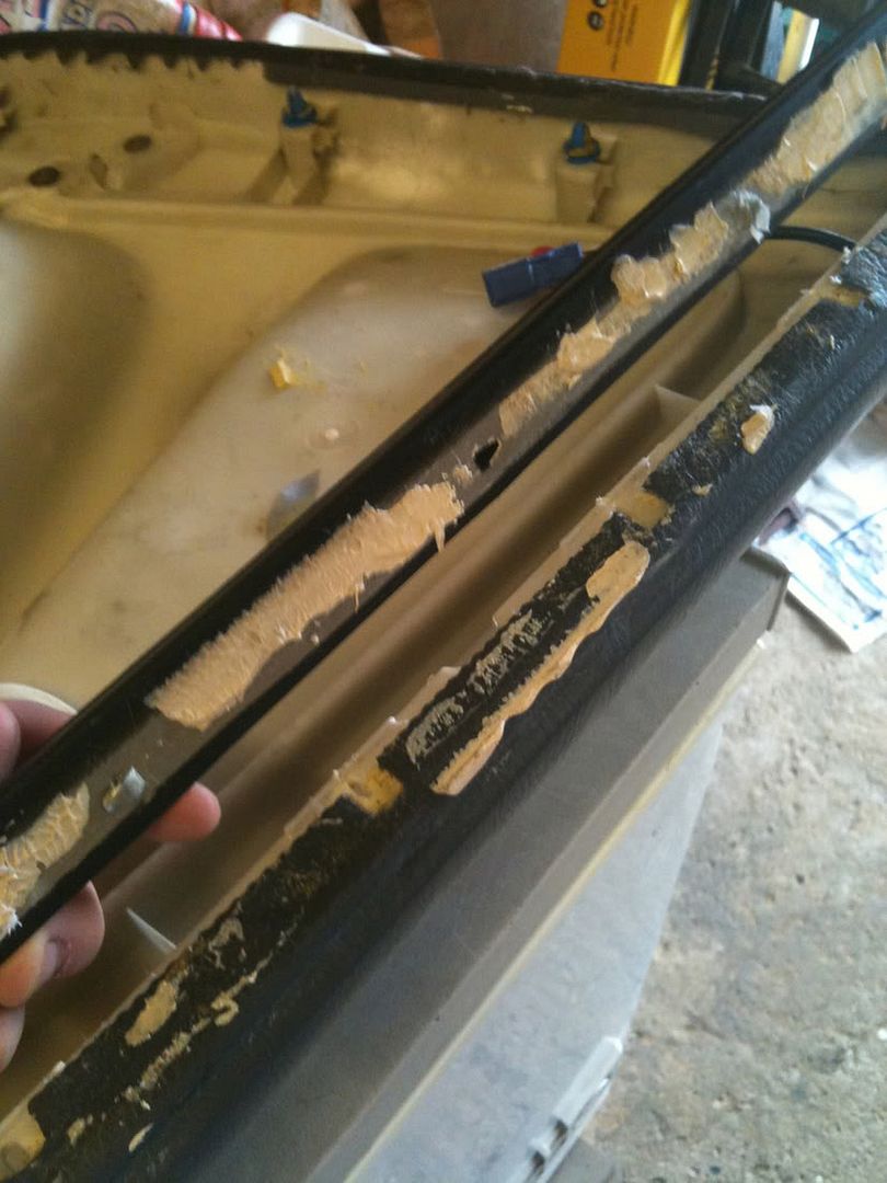

As above would use a 2pack epoxy resin type glue, or some sort of silicone
Theats the window top cheaper if I am looking at it right. That bit goes over the lip on the door.
If so they are clipped in. They have little metal prongs that are ben back and over into the door card. If its broken off the best thing I can say is use some glue from a glue gun as it needs to be hot to bond correctly.
No more nails will do but takes ages to go off hence the glue gun method. Also contact adesive may work again but this top section does take a beating with the window going up and down and all the downward fource from your arm leaning on the door too.
I did notice the metal prongs, I'll be folding them back when I stick it down.
Bought the araldite from b&q today, just waiting for some foam to come from eBay so I can pad out all the rattling bits and put it all back together.
