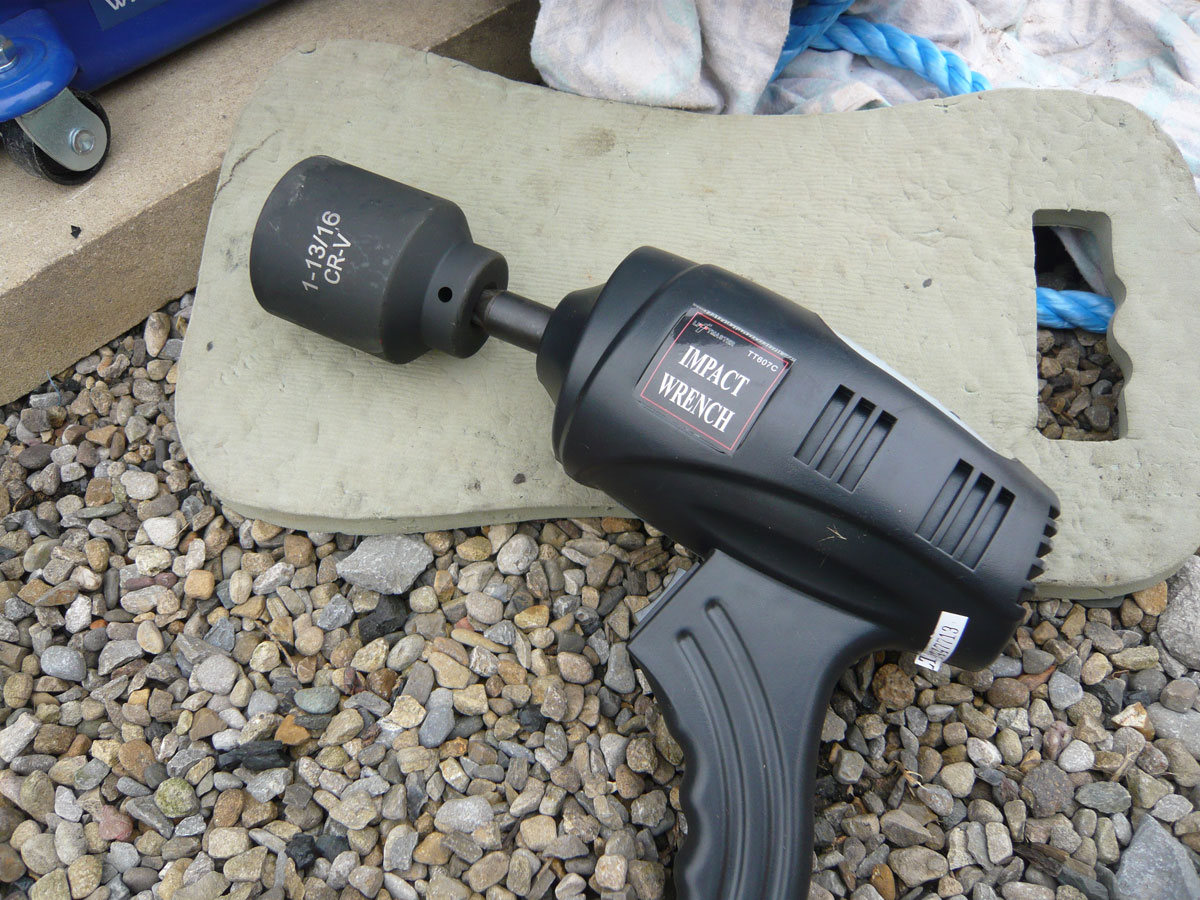

For the same job a few weeks ago, I got one of these, which worked well and has come in very handy since - designed to make it easier to get wheels nuts off but made short work of loosening the ball joint. It plugs into the cig lighter socket and was not expensive. Found on Amazon, 46mm socket from eBay.
I'll have it out again this weekend as I'm finally doing the other one, and the TREs.
