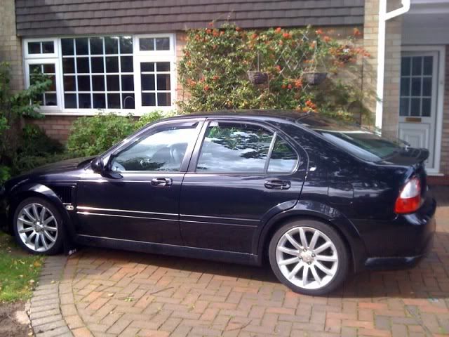

i got annoyed with mine last winter and had the dash out, found the ducting for the heater outlet was cracked and allowing air to escape under the dash. while i was at it i put some of that foam pipe insulation inside the metal duct that feeds the screen vents, by reducing the volume of the metal duct they're a lot more powerful now :D
i also brought some of those Rover 45 wind deflectors off ebay, the "heko" ones, so at least i can vent the windows during rain and snow and not get the interior all wet.
the window deflectors are great tbh, i can have the heater set to feet and face on speed 1 or 2, drop the front windows an inch and every window remains mist-free
the wind deflectors are the easiest option, ~£28 from ebay for a set of 4, as they are tinted they help stop the sun blinding you from the side, well unless the sun is super low in the sky :p
