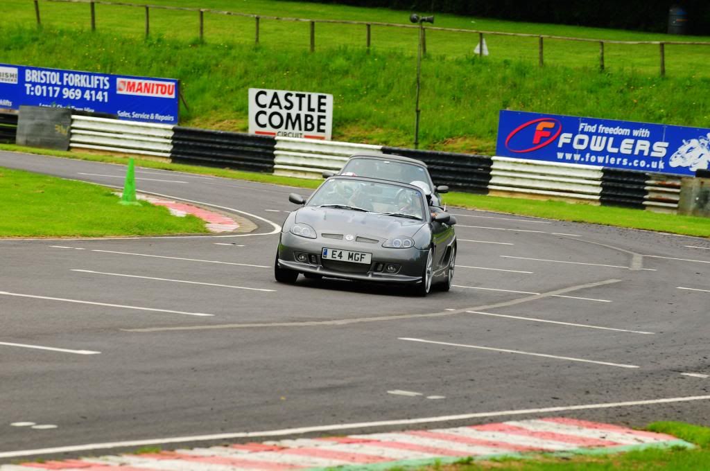

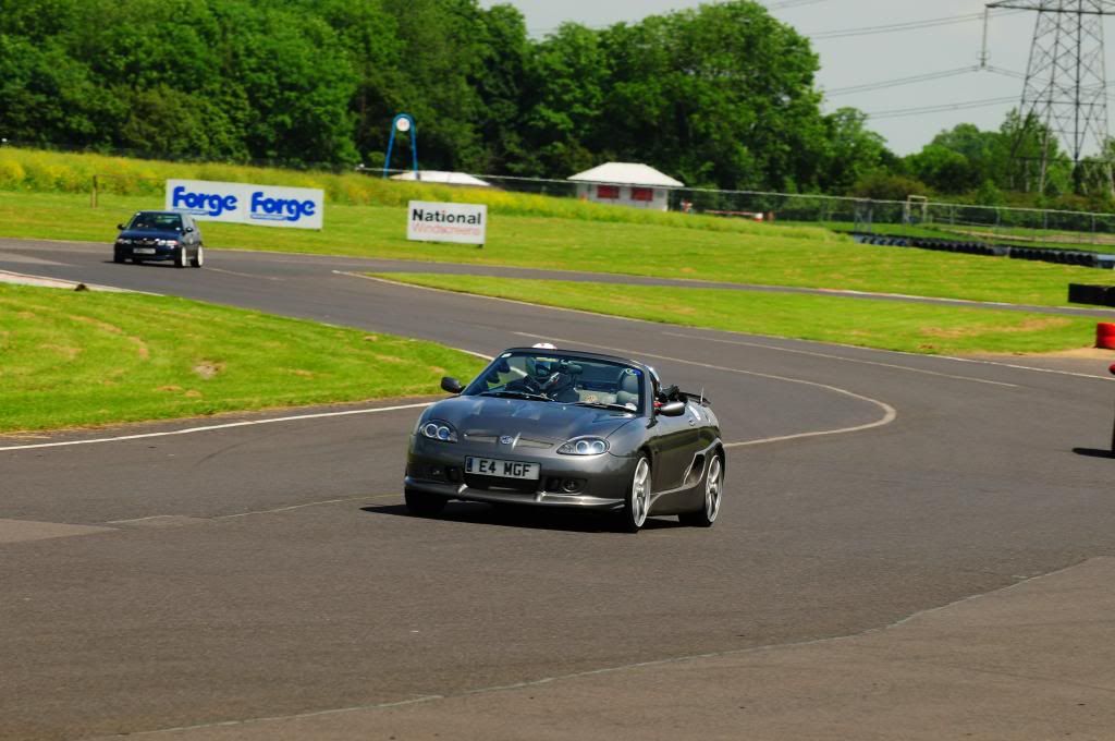

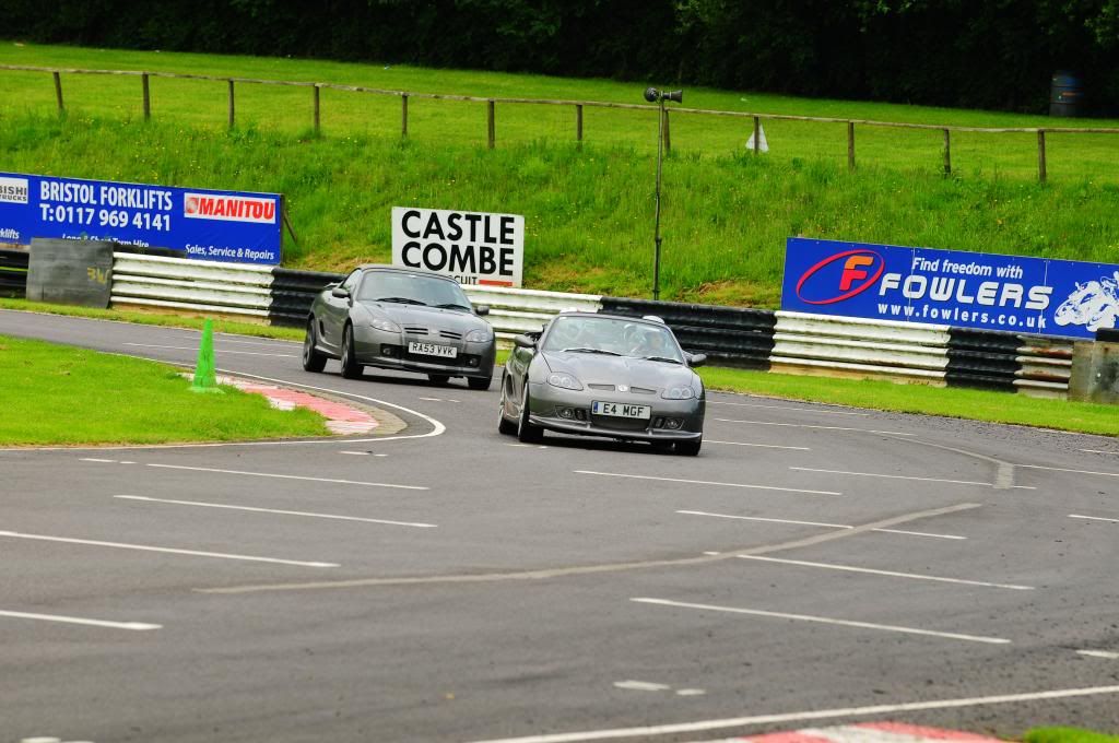

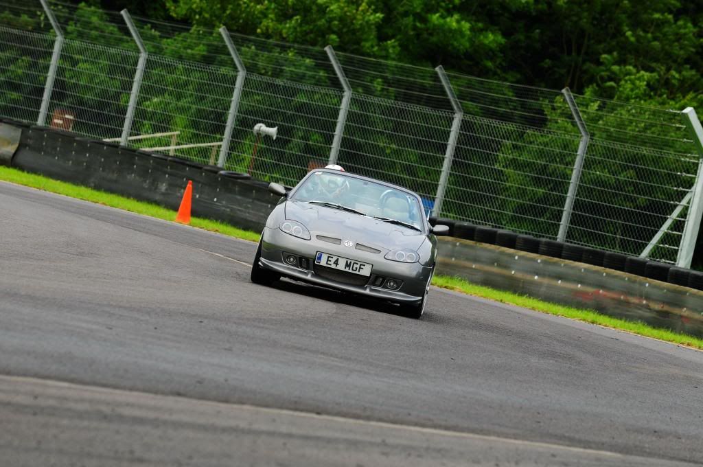

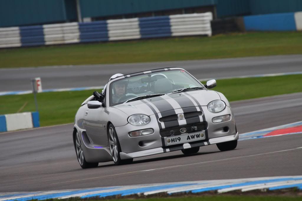

I did my first track day yesterday since fitting the new 304mm rear brakes and custom 23mm anti roll bars and the difference is amazing. Going into corners I was able to brake virtually at the turning point rather than the normal braking point and the car griped the road like glue all the way round, Cars that were sniffing at my heals going into the corner were left for dead by the end of it and took them half the straight to catch me again. below are couple of pics, first one taken at Donington Park with the old set up and the second yesterday at Castle Combe with the new set up, judge for yourselves. (despite the appearance it is the same car)

Great that the new set up works so well! Would be great to measure the 60-0 braking distance :D
And the cornering is pretty flat (in fact, that looks really undramatic - but I am sure the G-force is there!)

Andy.. Looks good now.. Suspension should be doing the work to keep the tyres on the ground.. And it can now the body roll has gone..
