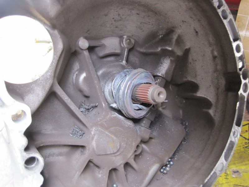

I never realised the simple Clutch Release Bearing was composed of so many parts .. some of its balls are missing ... :)
Here's pictures of the old and new Clutch Assemblies :~

No, the car was almost undriveable. Very strong burnt out clutch smell too.
You could select a gear, but, then difficult to come out of gear into neutral. The car would only move forward at a snail's pace .... clutch slipping. That was the puzzling part. I expected to see the clutch plate with polished friction plate rivets where they were in contact with the flywheel or cover plate but, not at all. All rivet heads were still below the friction surface although close to it.

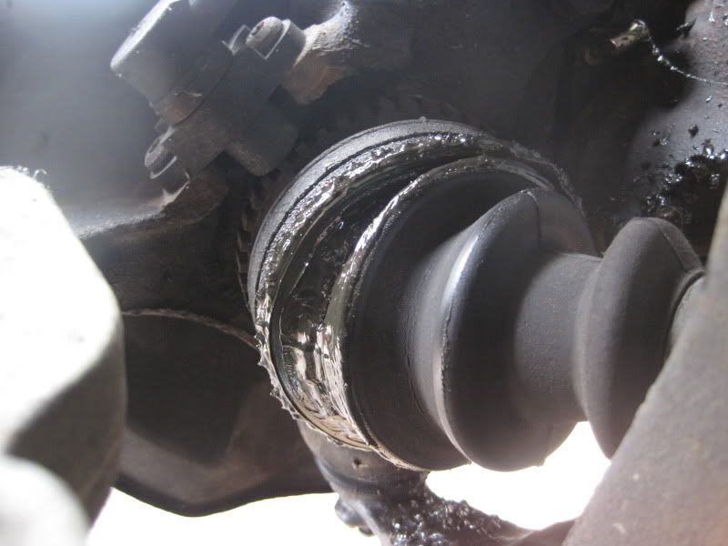

During the Clutch renewal work the nearside Differential Seal and Outer CV-Joint must have been damaged and both have been losing lubricant since then.

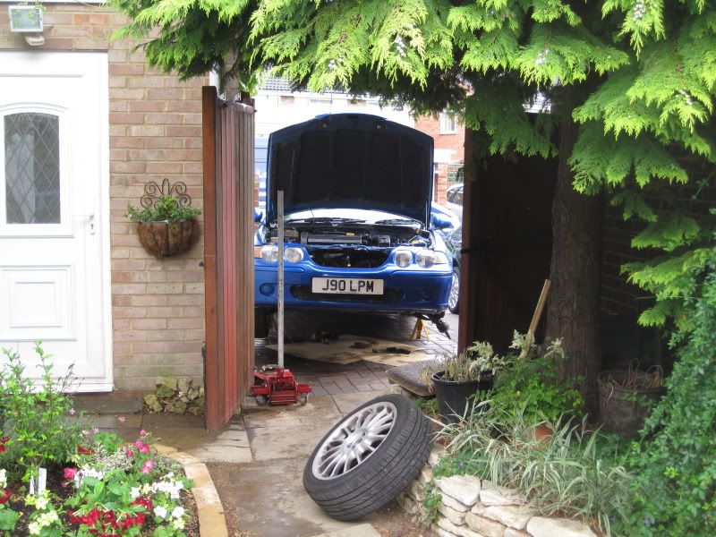

MoT due in a week so needed to get this work done. Got all my tools laid out ready and guess what, torrential rain. In between those heavy showers and the bright sunshine alternating every half hour, I managed to get both jobs done. The gearbox had only lost about half of its MTF 94.
Making a start :~

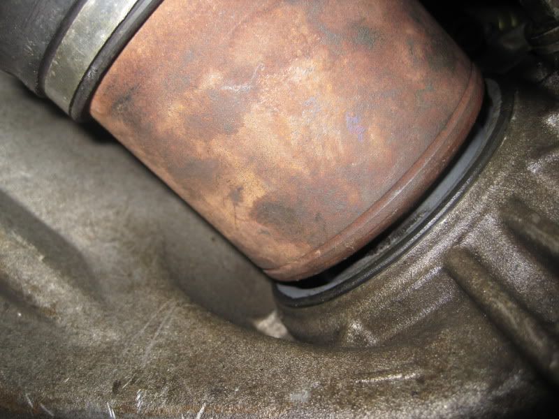

Yes, traces of lubricant where it should not be :~

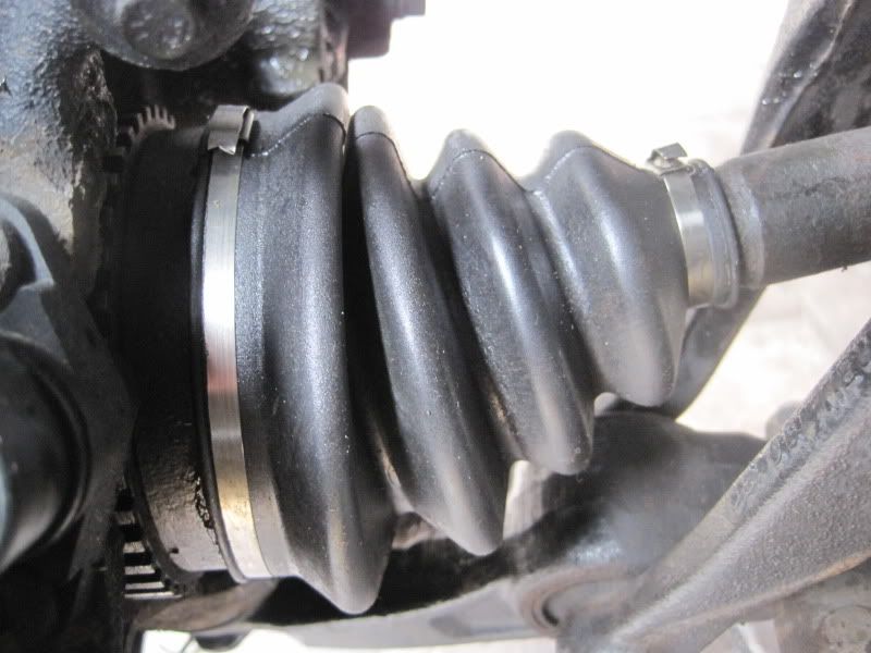

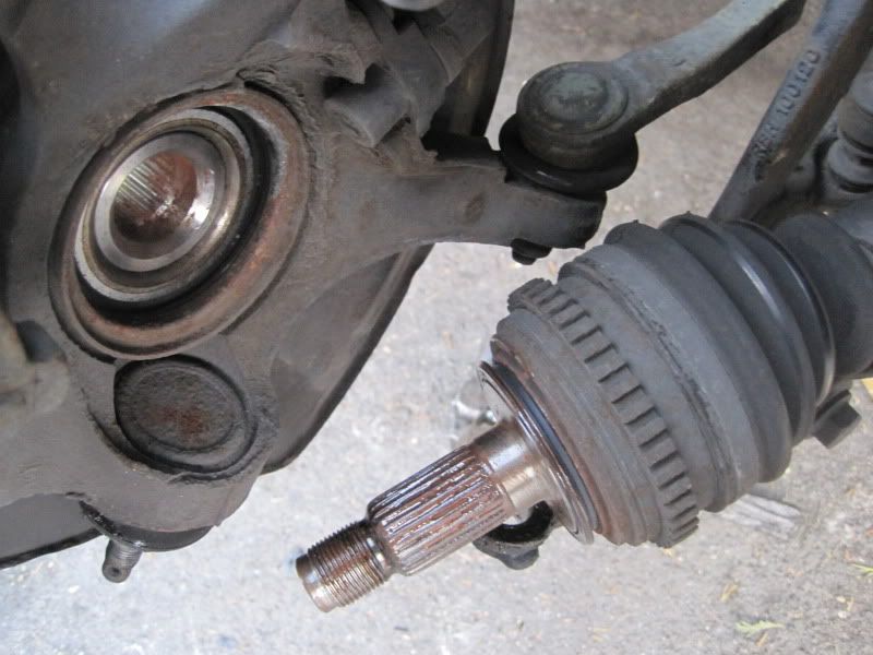

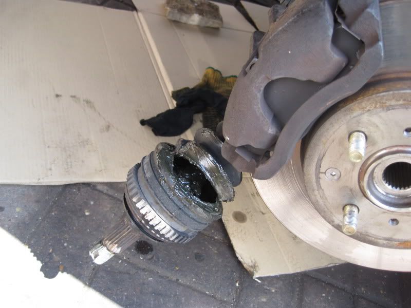

More bad news ~ torn CV-Joint Gaitor.
Shaft ready for removal from the car :~
Took a break for a cuppa and to give my joints time to recover. General view of the job in hand.

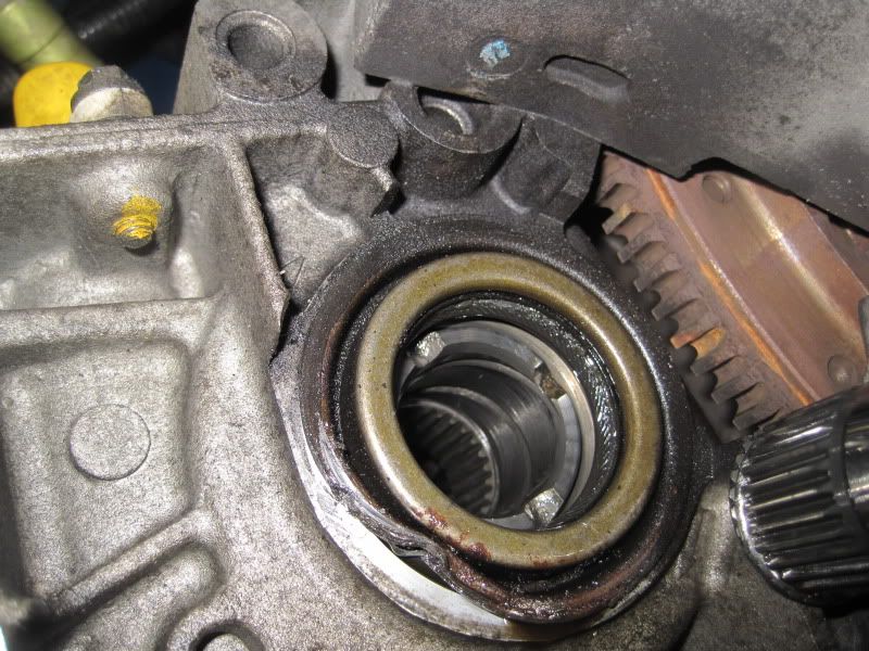

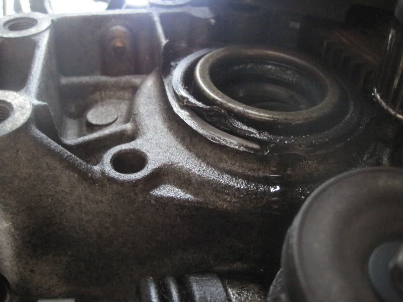

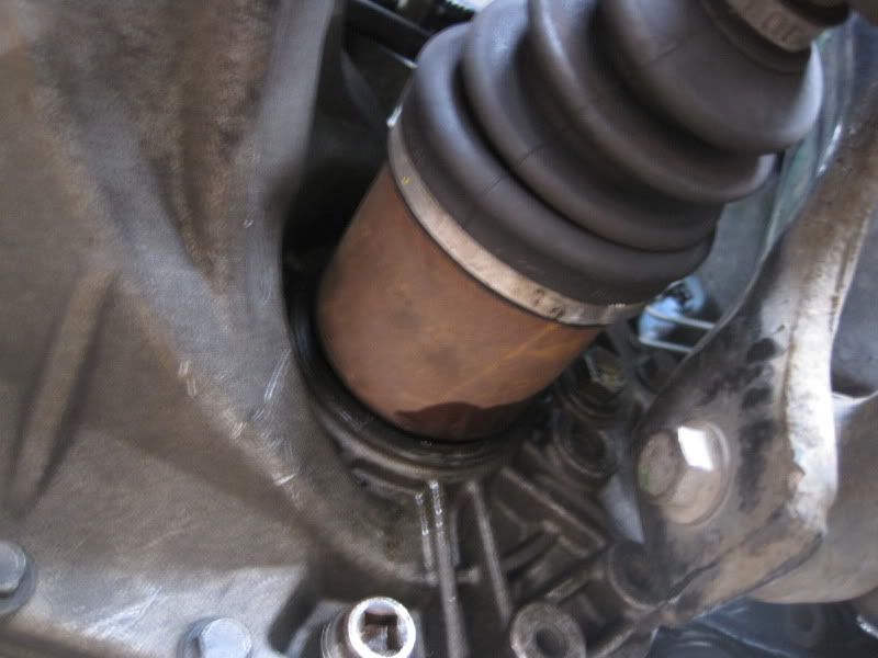

So, starting work at 6:30 this evening when the too warm for hard work warmer temperatures of the past few days started to drop, I got all the tools ready for the job and got stuck in. This first picture shows the damaged seal revealed when the driveshaft was removed. That process probably damaged the seal in the first place. You can clearly see the tracks of the lost lubricant.
The view from below :~

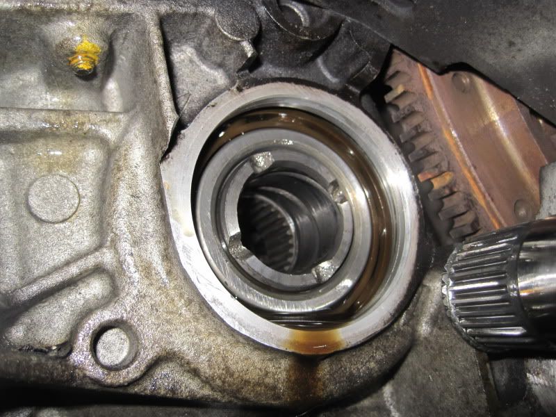

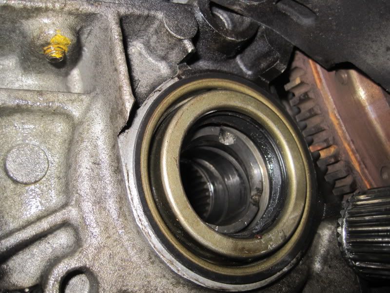

I used a large long screwdriver to prise out the damaged seal and cleaned up the location for the new seal. You can clearly see the Nylon Ball Cage of the Differential Bearings in this picture :~
Here the new seal is in place :~
