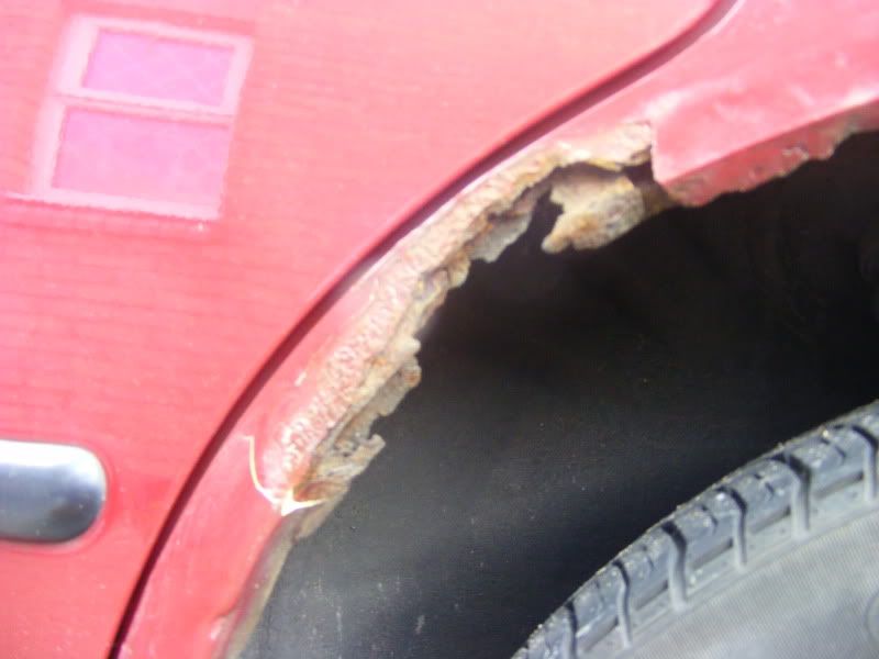

Well its been a busy day cutting out the rot etc....Its not pretty, but once i start to patch the holes with plates it should look better. I actually didnt think it was going to be so bad behind the bumper.....strange thing is the other side has only a tiny patch of rust about 2" square!..
Few pics as it was....

Excellent.. yours were far more gone than mine. Just had to cut out about 2" of the sills and a 3x4" in the inner arche against the boot. Allways more than meets the eye when it comes to rust....

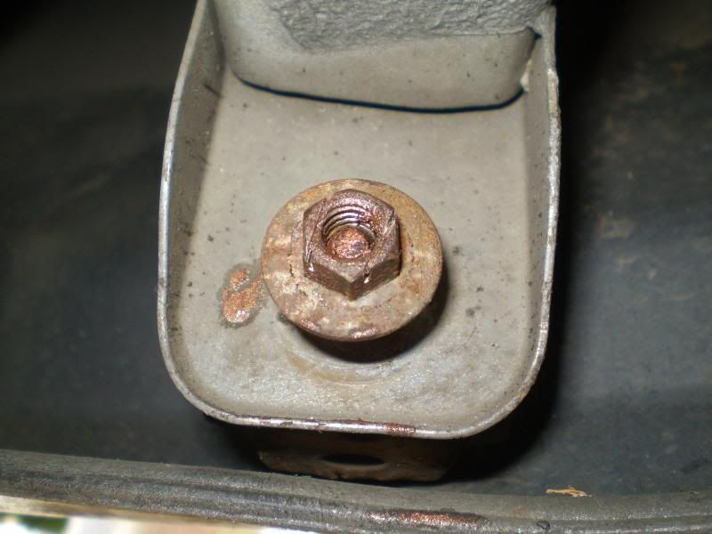

If you mean those two lower nuts/studs which are in a direct line of fire from the rear wheels and resulting corrosion weld. They rarely undo without sheering off.
Fortunately, I learned this on the breaker yard cars so with that in mind, I cut those lower nuts away with a junior hacksaw which avoids sheering off their studs. I use the same nuts you can access from Inside the boot behind the cloth trim which will be corrosion free.. use a tad of grease on those lower ones...
Remove a couple of nuts from inside the boot ~ corrosion free :~

Actually you don't have to the remove them. If you undo the nut shown in the last picture in MGJohns post, you can remove the bumper with the metal frame attached.
