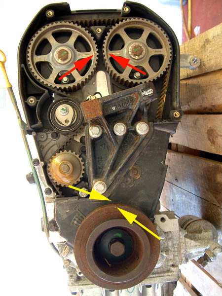

I would check your cam timing which can be hit and miss with the stock pulleys. It should be around 35 thou lift at TDC on the inlet and 30 thou lift at TDC on the exhaust.
There is an article on my website on how to check this.
www.dvpower.com
Dave

Depending on which cam is out, how much it is out and in which direction the results of incorrect cam timing can even mean an improvement in performance in some parts of the range. Just checking that the three timing marks are lined up is very simple and a good starting point.
If you have too much overlap this will mess up the MAP signal that the ECU relies on to run the engine, at idle this is critical. Once above 2000 RPM, this has a much smaller affect and you are much more likely to notice the change in the torque curve.
It's worth investing the time to check it before you go of on a wild goose chase.
Dave
Thanks both.
Just to make sure im checking the right thing, do i need to turn the engine over so that the bottom pulley is marked at TDC then check that the lettering on the cam pulleys line up?
As i say timing isnt my strong point, but i appreciate the help
Thanks
Thanks

Sorry but that only checks that the pulleys are in the right position and it needs to be done at 90BTDC. There is so much latency in the belt drive train that the cams can be a long way out even when the markings line up, in some caes up to 12 degrees.
with stock cams this is realtively unimportant as they are short duration, the more duration /valve acceleration you have the more significant this becomes.
The way to check your cam timing is right is to measure the lift at TDC and there is a method for doing this on my website at www.dvapower.com.
Lift at TDC for those cams should be 35-40 thou (.875 -> 1.0mm) on the inlet and 25-30 thou(0.625-0.75mm) on the exhaust.
If there are significantly different to this then that could be your problem.
Dave
