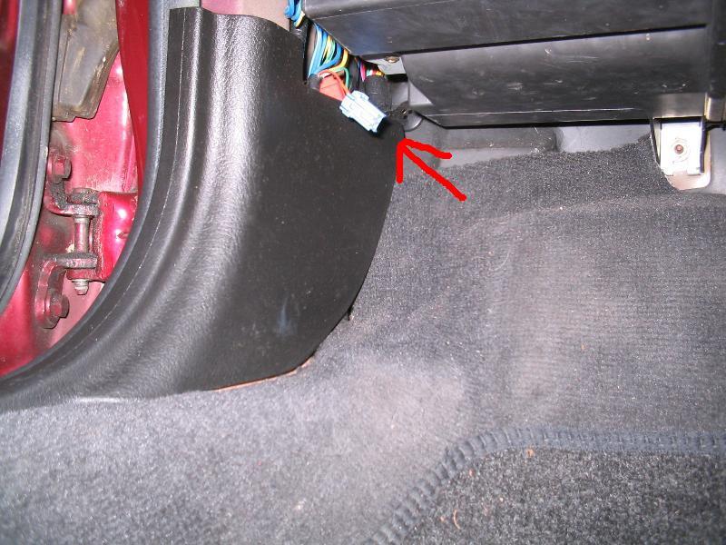

Locate the diagnostic plug in the passenger footwell, bridge the connector with a paper clip, turn the ignition to on (not start), if there is a fault stored the code will be displayed as a series of long and short flashes via the check engine light, 1 long = 10, 1 short = 1, get the code and post it here.
