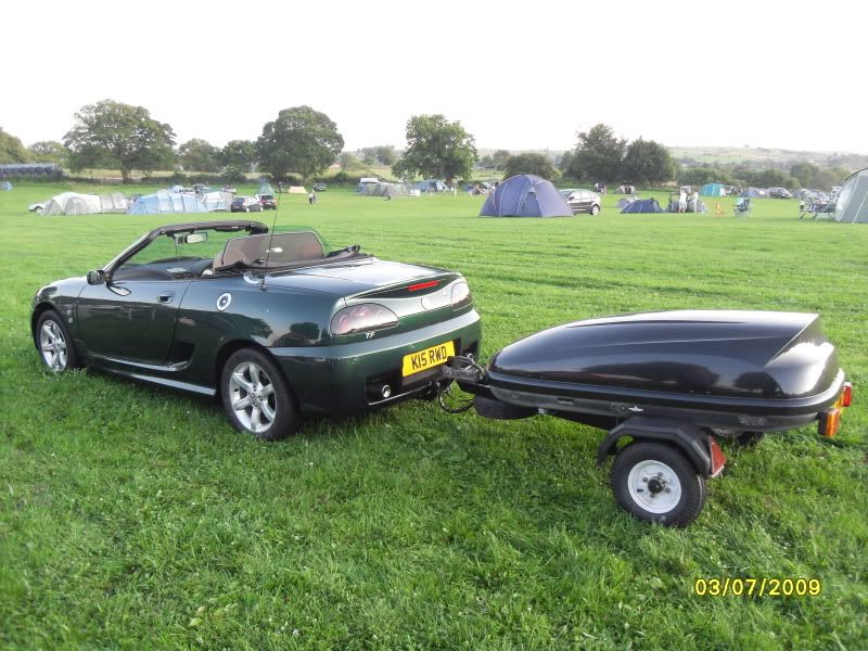

I spotted a tow bar on an F today so I took a couple of pics. It looks like the one that bolts to the car body, but to be honest it looked a little unstable to me, there are no other mounting points and it extends a long way.

I have asked the same question....a while ago and found this...
It wasn't recommended but there are a few on the T/TF forum who have a towbar....these picts are from a previous thread..
Found these picts
and this...............

Wow!! Thats made me think again....and the photos, they're brilliant.
