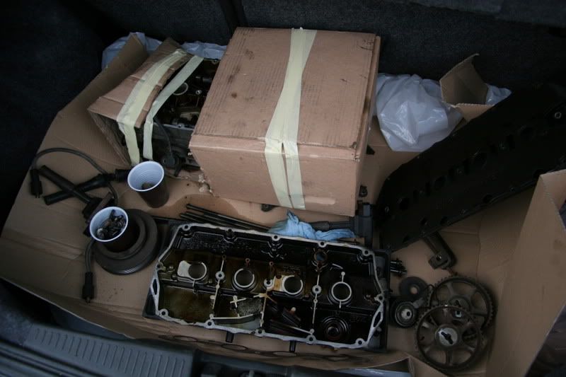

A mechanic mate of mines doesn't seem to think the damage is as drastic as the dealer made out. They very kindly left the engine stripped down and dumped it in the boot. I've taken a few pictures in the hope someone on here can see how bad the damage is. I know that the main bits when this happens are the gasket, valves and pistons.
This is whats left of the valves so I definately need these replacing.
Am I right in assuming that the pistons should have grooves cut in them already for the valves to sit flush with? From left to right as you look into the engine bay. Only the 2nd and 4th have any marks in them.

in all , i don't think its the worst thing that could have happened, its a fairly straight forward job. thought it sounds very bad. but the engine is definetly repairable.
your going to be needing to replace those pistons thats are stabbed aswell.
i get one of you mechanic buddys to sort it out, do you have a warrenty on the car?
how is the condition of the head, any damage to it?

To be honest, and I know I will probably be slated for this but If you don't have that sort of cash to throw around, reakon you could get away with just doing the valves or even a second hand head from ebay or the scrappy's Those pistons don't look that bad, I have certainly seen a lot worse and I know of occasions where the pistons have been left as is but this is usually on older cars.... still if you have the cash, its best to get it sorted but I know (God forbid) that it ever happens to me and I am not flush with the cash for repair and it looked like that, I would clean up the pistons and and just re build the head.
Obviously though, its your call and I am sure the consensus on here will be new pistons as well.
Good luck though.
Sean
17,398 Posts
Can't really make a comment on the pistons until they have been cleaned up first. That's the damage you can see. What about the rest of the bottom end, rods, bearings, crank etc.
What sort of state is the head in?

9,970 Posts
Are the valves even bent/damaged? All I see is some removed valves which look dirty....possibly damaged. Obviously its hard to tell damage from pics.
91 Posts
Yes the valves are deffinatley damaged, theres about 4 inches of valve stem missing from them all. what can be seen in the picture is only the head of the valves, there should be a long stem coming out of each one, looking a bit like an air horn

9,970 Posts
Oh yes. No idea why I diddnt realise the valves are missing there stems - they should be much longer.
It seems strange that they are all broken in the same place? Would they snap off like that at all - let alone several in the same place?....I am probably totally wrong - but when I first saw the picture I thought "looks like theyve put a grinder to the valves".

I've had this problem caused by tesioner bolt breaking. As well as valves most of my guides had bits broken off the bottom or were cracked.
I got valve & guide set to install myself but had to get seats recut, might have been easier to get machine shop to do it all.
It runs OK but it knocks when cold so I wish i'd looked at big ends now.
