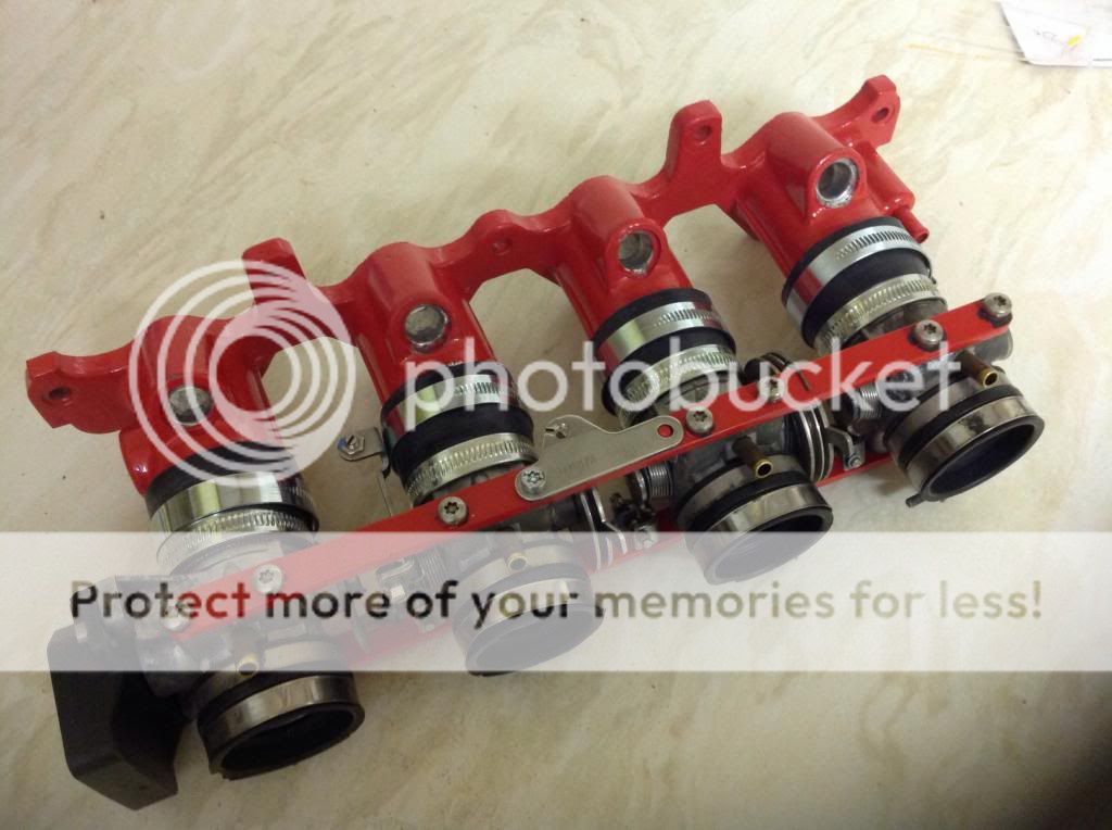

Engine wise, I've bought a set of BMW K1200 RS throttle bodies and have mounted them on a standard ally inlet manifold (I've fabricated some spacers to get them to line up). Wanted to use the original manifold so I can run the original injectors and same position. The inlet manifold & spacers as well as the cam cover are currently away being powder coated.
Need to sort a set of 90mm (length) trumpets and filter and work out how to mount it as well as getting a billet fuel rail made and work out how to mount that too!

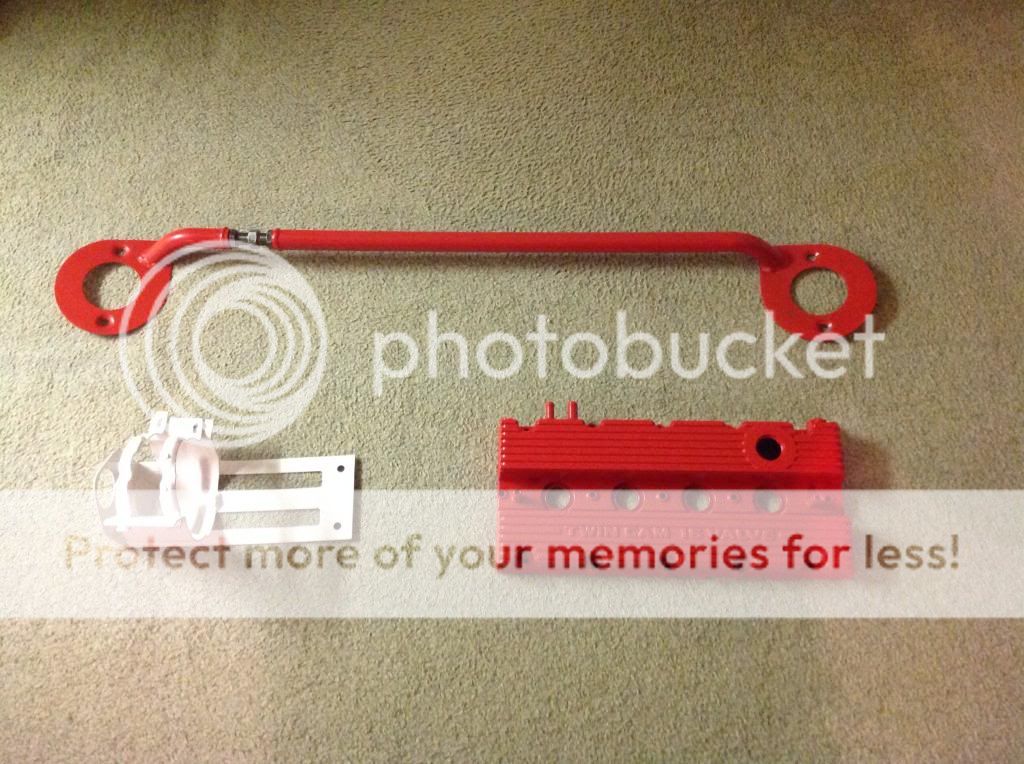

Will post a pic of the bodies, fuel rail etc when I've got all the bits together, in between time have one of my powder coated cam cover, strut brace and power steering bracket!

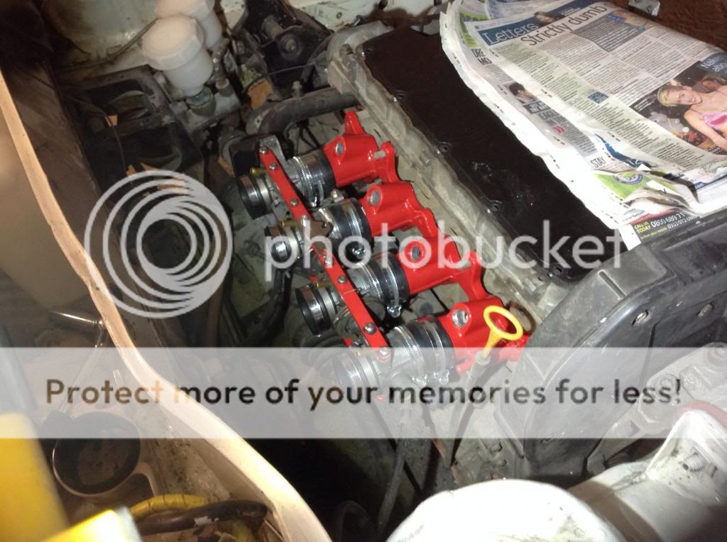

Picked up throttle bodies this afternoon with powder coated inlet manifold & spacer bars, please see below pics. I have just trial fitted them, they are now back off the car again so I can sort trumpets, filter and backplate.
#28 ·
That's a nice looking set up - do you know where the inlet manifold came from? It could be a cut down of a VVC alloy manifold :) And the throttle bodies?
I'm doing something similar - using GSXR600 bike 'bodies, and a cut down of the plastic inlet manifold :)
The set up is a little further forward than this picture shows, but I intend to continue with it over the winter :)
