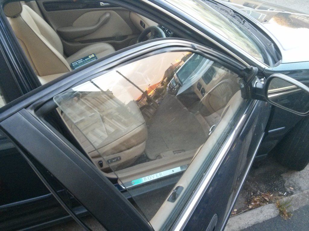

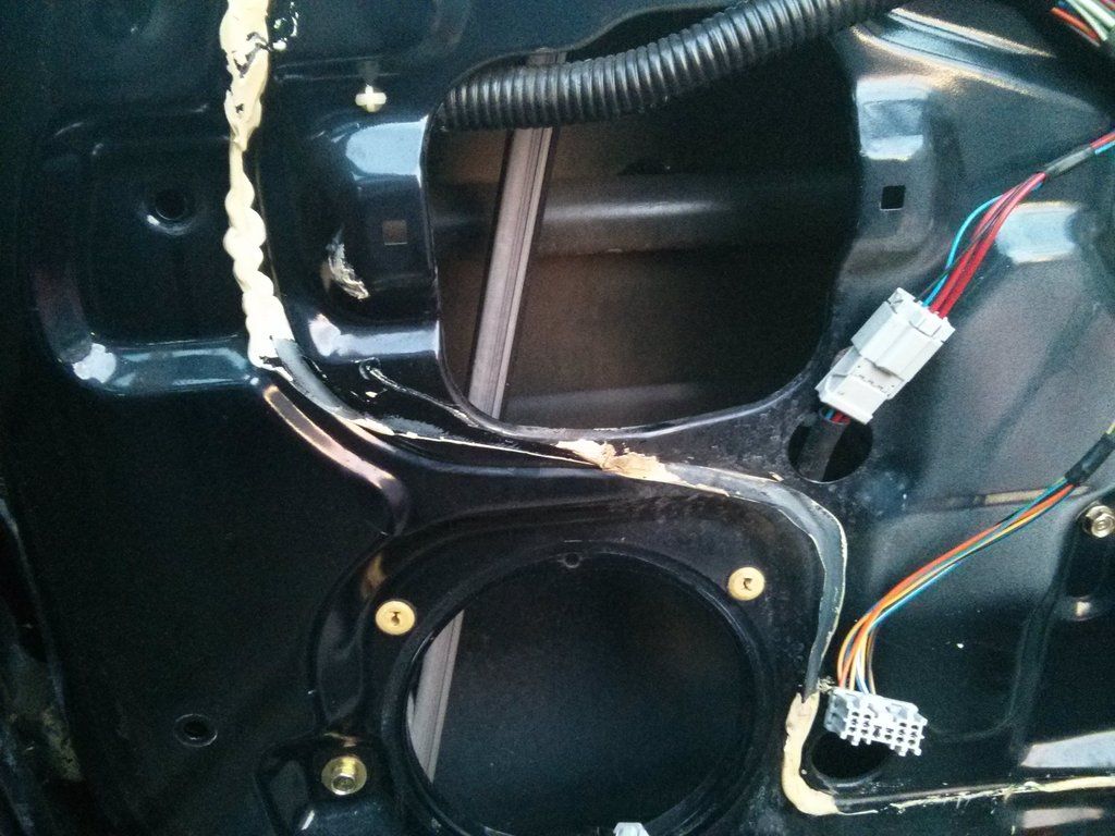

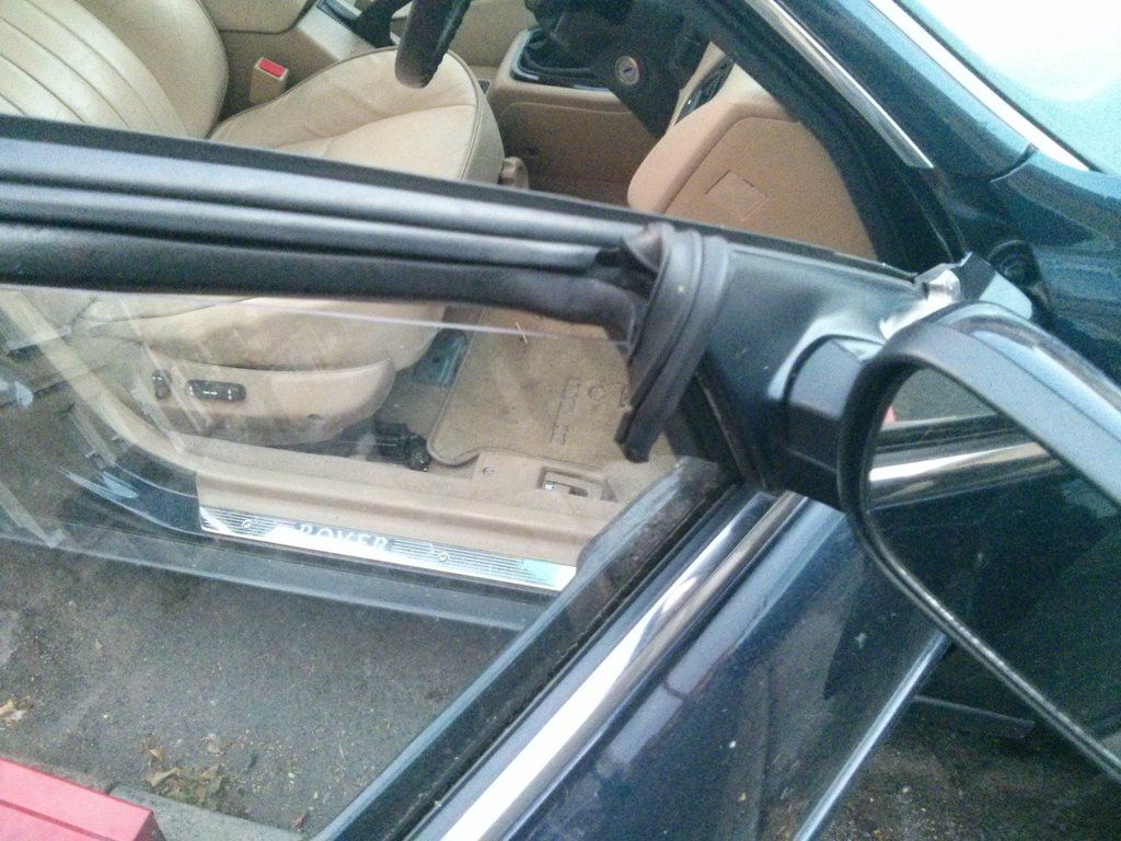

Hi Chaps,
So I have done some googling and it seems window regulators are a big issue.
Would you say from this set of pictures this is the issue?
So, is this a 5 spanner rating?! or something I could have a go at.
Thank you

Looks like a reg problem; fiddly rather than difficult. Here's some notes I made last time I did one;
Remove door card
Remove door opener; take out screw; slide forward and out; undo the clip and pull out the push rod.
Remove two screws from the door handle and screw from bottom right of door
Remove clip from top LHS
Use remover to undo clips and then UNDO THE WIRES !!!
Remove glass
Lower window until holding bolts (10mm) line up with lower cuts outs then remove the two screws.
Raise glass and lift forward and out of door.
Remove 4 screws and speaker
MARK POSITION OF REGULATOR
Lower regulator to its middle position
Loosen 6 bolts10mm
Extract regulator from bottom RH hole
The 3 screws hold motor to regulator; one only accessible when motor at end point
When re-install regulator, connect and wind to mid point of crank; the gearbox is facing the installer
4 long bolts on crank assembly 2 short bolts on support bracket
The motor connects do not go to the door card but go back inside door through hole above speaker.
Thick wires; red-yellow and red-blue; Thin wires black and blue
Some people say that you can straighten a bent regulator, but IMHO, I'd go for a replacement.

It could also be something as simple as the glass rubbers need lube. My driver's side kept popping out of the runners so I lubed the rubbers with GT85, put the glass back in the rubbers and all works fine. Worth trying that before stripping out the regulator.
My local branch of Boyes were selling silicone spray @ £2.00 for a large can recently.
Got a couple just for the 600's windows.:)
Window rubbers should be lubed at every service/oil change in my opinion.
