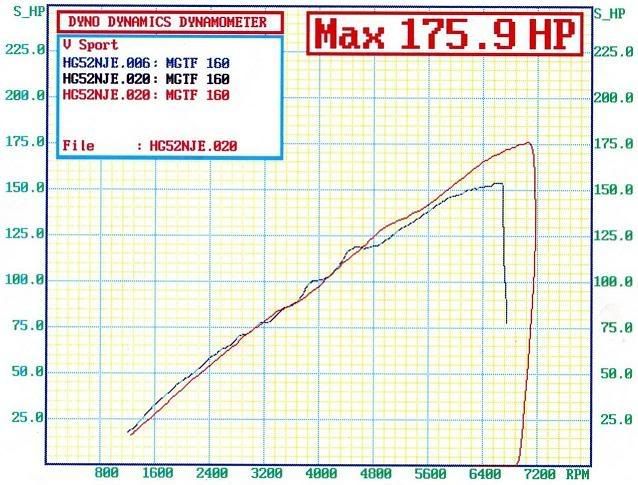

I Had the Rolling road 1st to find out what it was kicking out
result
153bhp. This was very underpowered and really shocked me to the point i thought something was wrong with the car but i was supprised as the car feels very fast for a 160. so i was a tad gutted i was so far underpowered!
anyway when it came to doing the re-map which should have been a case of just swapping a map over they already had, it turned out mine was a very strange map setup apparently which they hadn't seen and totally different to the others so it took a while to get the file off the car and map it and get it back on....eventually they manged it.
Result after re-map
175.9 :) so i was pretty chuffed to find from having the lowest bhp of them all to leapfrogging one of them and 0.1bhp off the other so in effect i also got the 176bhp really :)
I was very relieved at this point i can tell ya lol
anyway eventually after finding a NOS fillup station they put it back on the Rolling road to see what it would do with 25shot of NOS too and the guys at the RR garage where all buzzing their heads off cos of how it reacted.....I can tell ya i was very nervous cos you should not bounce off the limiter with nos but they had to for the Rolling road tests.
result with nos
193.6 bhp :D :D :D I can tell ya i was buzzing my head off lol. :)
anyway thoughts of the re-map.
this re-map gave me a total of 22-23 BHP Gain from 153bhp to 176BHP which is a massive gain to say these cars "couldn't" be mapped and nothing was added to the car and the car now drives like it has permanent NOS switched on.. and when i hit the NOS now it really takes off and i'm hitting almost 200BHP in a tiny car like this lol :)
to hit 200BHP i could either just throw the 50shot jet in and get around 220 BHP or i have a few little tweeks i need to look at cos i messed about with my filter last week and i'm pretty sure i lost power there so i have a feeling the 153bhp is the effect of the filter so i need to check a few things out.
Very very impressed though and the car drives so much more smoothly than it ever did and bang for buck a great buy for me to gain 22-23 BHP
i'd seriously recommend this Garage for a re-map any day.... top guys and really seemed to know what they were doing and looked after the car :)

More than happy with it mate, now i'm home of that motorway and away from the traffic i went out for a proper drive on normal roads and it's absolutley fantastic tbh and that nos kick is just summat else lol :)
it was really cool to meet you too mate, nice of you to hang around all day too m8 and keep me company ;) deffinately didn't think you looked like ya do though lmao....i was expecting that robot in your avatar ;) so nice though to put a face to the name now :) and good to hear 1st hand sll your plans rather than keep reading them :)
the car has a 4-2-1 manifold and janspeed backbox and ind kit.
tbh it's got me thinking actually that both myself and CJJ have the 4-2-1 manifold yet romeo is standard right through apart from the filter yet me and cjj where both way down on bhp so it seems.
this has me thinkin perhaps the 4-2-1 manifold isn't all it's cracked up to be?? the problem is ya cant really do a before and after with the maifold unless you fancy spending all day tryin to get the thing on/off the car as it's not the easiest thing to fit......tbh i'd remove the 4-2-1 if it proves to decrease power......maybe CJJ will be the mug, i mean person to take it back off and try again ;)
See, we are getting caught up in the pub figures again. I prefer my 8bhp lead in the mid range, not in the peak power.:D
Even if it gained me 5bhp pub bhp I wouldn't do it because I think I would lose the mid range gain. Anyway, it sounds nice.
I don't think it is to do with the manifold as my original RR came in at 151.1 bhp and that was without the manifold.
I think that MyRomeo was just lucky to get a good engine in the first place, we will never know because he didn't do a before RR.
One thing that seems apparent is that these engines were thrown together in such a way that there can be 10bhp difference on standard engines. The remap seems to bring them back to a level playing field.

ya not kidding about being thrown together, what the hell was that map of mine all about being totally different and confusing for them lol ? its like they just threw any map on any car and if it ran cool. to think a remap can bring them all in line is wierd, so maybe not so much 1 has a good engine but just has/had a better map
#15 ·
lmao, summat like that ;) although i got dogged for most of the day for squirming everytime i heard my car banging on that limiter lol...
which reminds me about the rev limit.
all our 3 160's redline @ 7200 on the counter yet the rr picks it up at redline somehwere between 6500-6800rpm so now he's changed them all to actual 7200 red line it now goes over the actual redline on the car.....looks like they don't match the dials and they lied about the rev limit

Cheers Jan, tbh i was well naffed when i 1st saw the original figure of 153.6 and it had me worried a tad especially when they started telling me it was a very wierd map i had on but once i got the new figures which put me up with the others i was more than chuffed and relieved lol. So i dont really care now what it was giving :)
and i still have a few tweeks to do this weekend if i get time, more so on my air filter cos i'm convinced i bogged the car down a little, only problem is i won't know cos it won't be having a RR before & after.

I'm guessing that most of the gains are mapping the car to use 95RON rather than the manufacturers tolerance for lower octane fuels? So the ignition becomes more advanced over the map?
If so, how does their mapping computer know how much it can safely advance the ignition? I think I need to go and do some reading...

According to Dave it is very difficult to knobble these machines, as they flag up fault codes if you try to adjust the temperature etc to give a false reading.
The rolling roads that they use (Dyno Dynamics) are respected around the world and are the only ones used by some clubs for RR shootouts.
I take comfort in the fact that it can't really be reading high, due to initial low (or standard according to Jans figures) RR figures, and can't reading low due to the final figures of 175 ish.

Good to meet you tho and i pulled 176.7, so ya0.8 off lol. Not bad at all eh! Seems the 160 responds well to the remap consistently pulling about 175 :)

well i've been in my car quite a bit since yesterday and the drivability of my car is fantastic, far far smoother than it ever was that's for sure and the delivery of power is fantastic and like Romeo has said, I no longer have to feel i need to drop down a gear for any power. Seriously the car now feels like it did before with the nos on although the delivery of power is very different ya can certainly feel the pull now all the way through the rev range and it just doesn't stop pulling :) With NOS though OMG!!! it's absolutely stunning performance now :)

As for driving, notice it a lot yes, for my car it really gives a big kick at 3750 when vvc comes in, it literally pulls you back. I am more than pleased with the result and can't recommend the remap enough. Where before i would have dropped into 4th for motorway overtaking i'm now able to leave in 5th to the same end result. Seem to be getting a few more mpg sinc the remap too, up from 34 to 37 average and 390 miles to the tank. I'm sure cjj and baracus will say similar.
