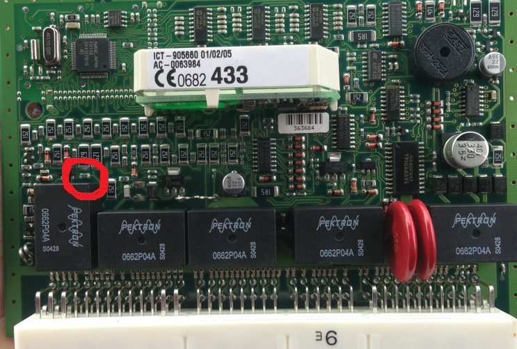

mg stress then relief
Ok had a go at replacing 2 relays in the scu today. Stressed because the scu is sooo important and did not want to do it wrong.
Car unlocked, turned engine over. Battery disconnected.
I undid both sides of the centre console. I undid both sides of the bracket holding the scu. Longer to do but easier to remove the unit.
Marked the connectors ( did not need to as they are all different sizes)
Pushed in tabs on the connectors to pull them free. Not stressed yet.
Scu out. Gentle prising with a small slotted screw driver to remove the base part of the scu box.
Earthed myself against a radiator pipe.
45watt soldering iron de soldered the legs of a relay.
I couldn't find a pic of the circuit board upside down. I eyed up which pads to de solder. The tip on my soldering iron was a little dirty. It did not do a great job. Relay not budging.
Very stressed. Time for a cuppa.
A new tip and solder sucker later, job desoldered. However the relay would still not come out. I very gently rocked the relay away from the pads that had no solder still in them. The final pads i used another iron with a pointed tip to push the legs through.
This took ages to remove one relay.
Relief. I soldered the new one in, in about 5 minutes.
All connected and I have a working drivers window. 3 years without it.
Technozen. supplied the bits and info needed. Many, many thanks.

Pektron scu
hi how much would it be to solder a TPIC6C595 in to the scu as the horn is constantly on i have already put all five relays in but this one is a bit harder to do and i feel that a would mess it up any help would be appreciated
