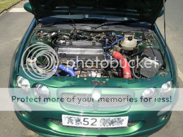

A new chapter begins today following a quick fling with the VAG crowd in an Audi TT. Not really sure on a direction yet in terms of styling or tuning. I have to say this is a rebuilt T-16 engine with a GT28RS which is currently plenty fast as it is. SIck thing is my insurance was ÂŁ100 only more than my last Rover :s (Good old Adrian Flux).
First thing to go will be the alloys followed swiftly by a suspension swap as I believe in has a Koni front and Gmax rear - Coilies?? Possibly.
Let me introduce my new project -
The car shell has covered 60,000 miles and the Engine has now covered around 82,000
Engine with:
*New bearings/ gaskets throughout
*Tickford turbo pistons and rods
*Gt28rs Turbo running approx 14psi
*Snake head downpipe
*Over boost chip
*Air Filter
*Baileys dump valve
*Battery relocated to Boot
*Fast Road uprated Clutch
Chasis
*Zr 160 Struts with Xpower Diesel lowered Springs
*Zr 160 front brakes with black diamond groved disks and ebc red stuff pads
*Zr 160 rear disk brakes with black diamond groved disks and ebc oem pads
*Goodridge Braided Brake Hoses all round
*Magnex Oval back box and de-cat
Misc.
*Full leather interior
*BRM Gear Knob
*Leather Armrest
*Dash Pocket
*Boost Gauge
*HIDs
