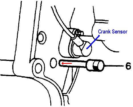

need help finding the hole to insert the 6.75 mm drill into
1338 Views 14 Replies 5 Participants Last post by  CCM
hi
im in the middle of changiing the belts and im stuck on the part where you lock the flywheel to remove the cambelt ?
can abyone tell me how to get to it of show me a pic where it is .
needed asap need car by 4 pm !!!!!
cheers.

i dont have a picture to hand but...
locate where the driver's side driveshaft enters the gearbox. above this there is the crank sensor, in this very area there is a small hole to put your drill bit into. i would advise using a bright torch as its hard to see it without one

thanks that worked great now im having truble removing the engine mount plate any ideas on how to do it ?
well first off big thanks to russ would neer have found the hole without your help cheers mate rep you way :)
