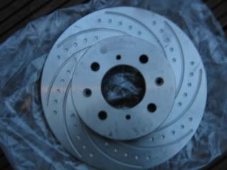

Just got my new discs delivered today , after reading someones post on here i decided to get the dimpled and grooved ones, will these make much of a difference in stopping power compared to the standard.
Not as such, you just wont suffer from heat fade as easily. More stopping power needs bigger discs and/or a different disc compound (coupled with better calipers and pads)
yeah stopping quickly from 70 doesnt really feel that safe, may get bigger brakes in the future when i get some cash ,meant to be going on holiday next week so got that to pay for, but these will do for now, thanks for the reply.
As said they're more for looks rather than performance, do look really cool though, i'll be getting some similar brakes for when I get my 160 as I have 5 spoke wheels so they are highly visible.
nice looking brakes im looking for a pair of them but 282mm when i get some cash.

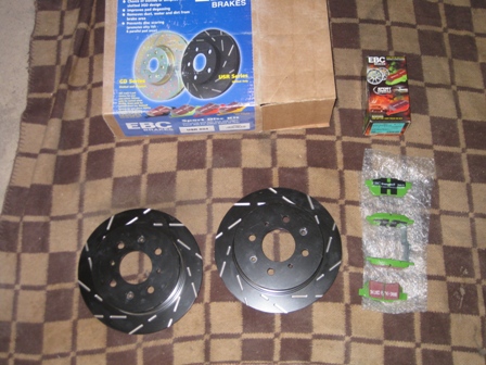

you got your discs and i´m still waiting for mine
ordered the blackdash(ultimax) discs over half a year ago @ banshee-motorsport -> they are not able to send them without delivery errors
i allready got redstuff´s , goodridge braided hoses , EBC high performance brake fluid -> but discs still missing :(
they look so nice ^^
