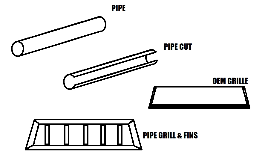

I would get some standard plastic sink waste pipe and cut out a quarter of it lenghtways and then angle cuts each end to fit on the lower grille edges and add central fins, I tried this on mine but went a different round but I got a good basis bult but I sold it on to one of the guys who went to our local meet.

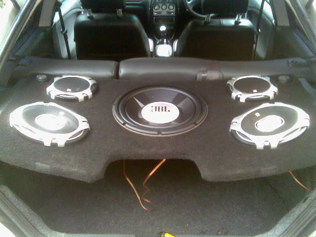

Great choice on speakers, big fan of JBL myself, used lots over the years, I still have this set up in my 25.
For now I am really satisfied with the sound quality that I have achieved and the cost of doing so
Nor do I plan to put any more speakers, which I have now assembled seems more than enough to listen to music while enjoying the car.
