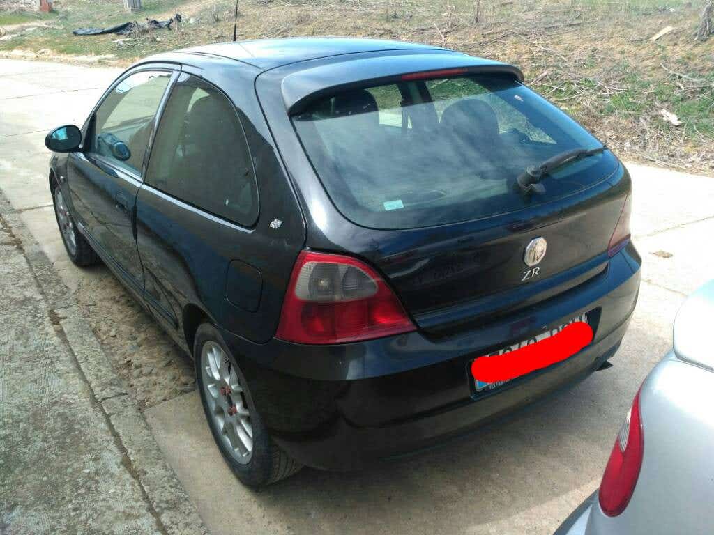

I'll introduce you to my MG ZR.
It's my third ZR, I previously had two others but I suffered a exit road with the first one and with the second I got a boar on the highway and the car was destroyed.
This in the state in which I acquired the car, was April 2017, with the clear intention of doing a complete restoration.
As you can see, both inside and outside the car is very deteriorated, the engine is apparently healthy.

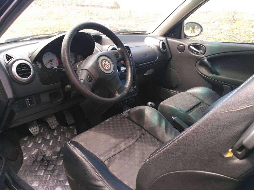

In August 2017, taking advantage of the summer holidays, the interior has been completely changed (when I have finally finished restoring the interior).
He has been given the seats of a ZR 160 MK2.
Upgraded interior plastic and dashboard for those of an MK1, along with the central console of a streetwise, still need to finish adapting a pair of connectors (front fog lights and door lock) as seen in the images, I still have That even receive the material to be able to do it.
In spite of having a complete interior of MK2 and that initially thought to leave it as it was, the interior design of the MK2 does not stop me liking and in the end I decided to make the conversion to MK1, contrary to what many do for the forum, I prefer the outside appearance of MK2 and the interior of MK1.
Installed electric mirrors.
Received the rear side windows of my first ZR, which were tinted barely a week before suffering the accident, and did not even get the sun, I need to take to tinting the rear window with the same solar sheet.
The roof was completely detached, so it has been reupholstered in black, in a future the plastics of the interior pillars and as the sunshades were painted in black.
As work pending ...

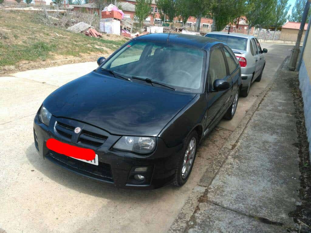

Aerodynamic kit intalled
Now It needs a "lifting" and a coat of paint.
