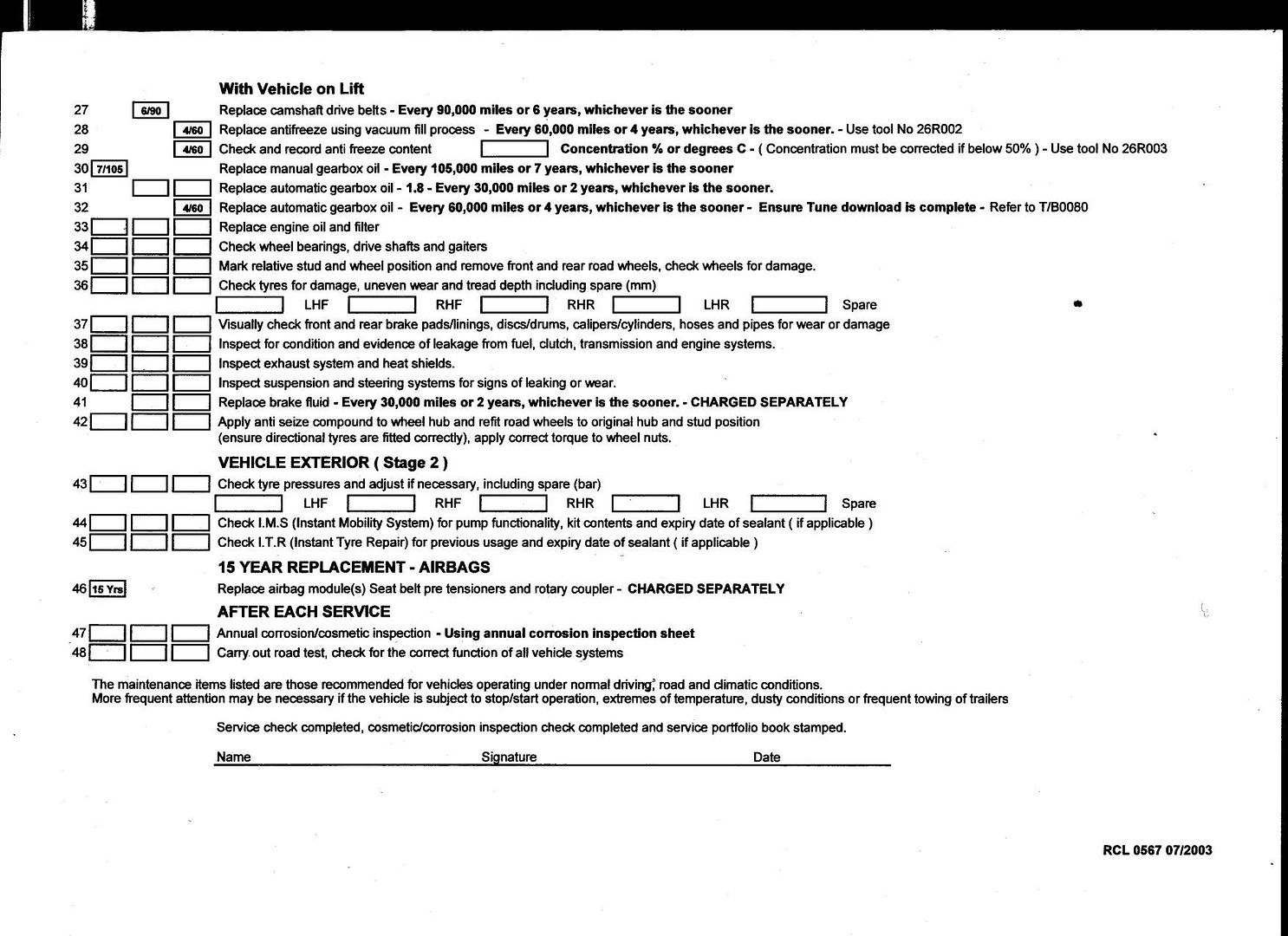

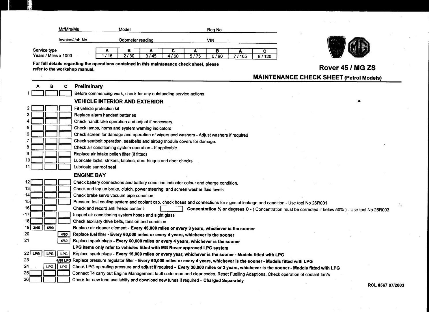

I use a copy of the service sheets, Shroonie has linked to, to tell my garage what needs doing each year. Depends if you use an MGR specialist as to whether they know what needs doing. At 4 year service last year there was quite a bit.
Oil & Filter
Pollen Filter
Air filter if not done at 3 year
Fuel filter
Coolant change
Spark Plugs (bought off e-bay)
Brake Fluid (every 2 years)
Check exhaust, I have just replaced (at 5 years old) mid and rear sections with genuine MGR parts at ÂŁ285 including fitting.

I did them, even though the car had only done 24k as I tend to be cautious and do things by the book, especially when I don't totally understand the mechanics of the items/fluids and how they may deteriorate.
