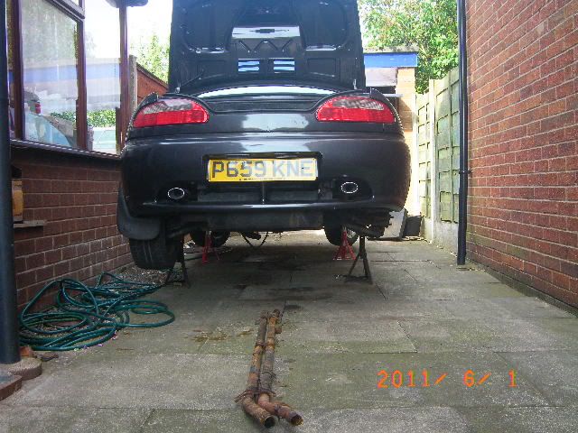

I thought I would start finding out what bits I need for my new project today and decided to put the grey F on axle stands so I can get access underneath from all sides.

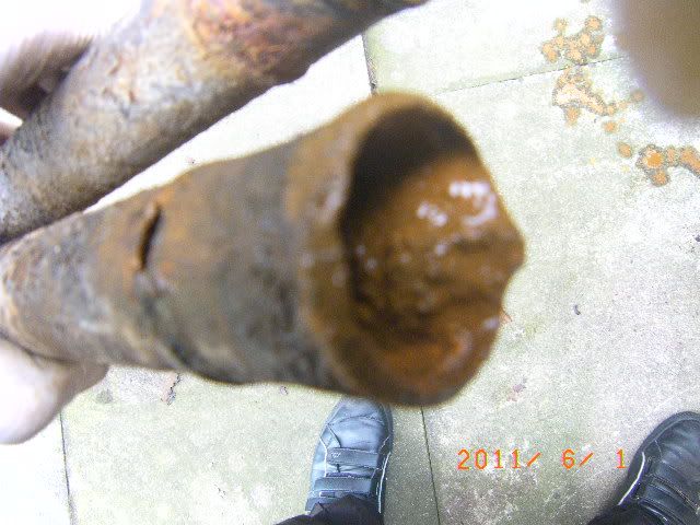

Then knowing the steel pipes from the radiator to engine need replacing I thought I would remove those first, once off I found not only were they full of the horrible thick creamy gunge but one of them looked like it had exploded.
I can't see the pressure of the water causing this so I must presume that as the previous owner was trying to restore it he left it full of the gungy stuff over the winter and it expanded and burst the steel pipe.
Above is the hole and below the gunge that filled not only the engine but all the hoses as well.

Just replaced the pipes on my car - its 11, and done 60k miles. I guess they were designed to last "10 years or 100k - whichever comes first" ;)
Replaced my pipes with SS :)

I drive in -30 every winter and that has never happened to me, So, the cold winter you just had combined with a higher freezing point of the mix of oil and water and a little coolant would do the trick, also the pipes looked like that are more rust than steel....... SS is the way to go.....
