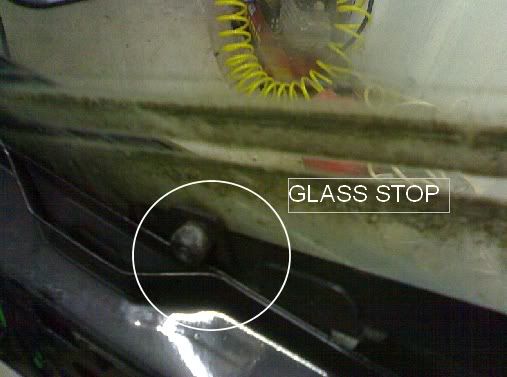

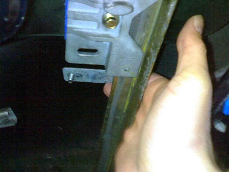

With the door card removed and the protective polythene layer removed, the first job is to remove the door glass. Move the window down to gain access to the rear mount bracket and remove the 10mm bolt holding the support bracket in place.

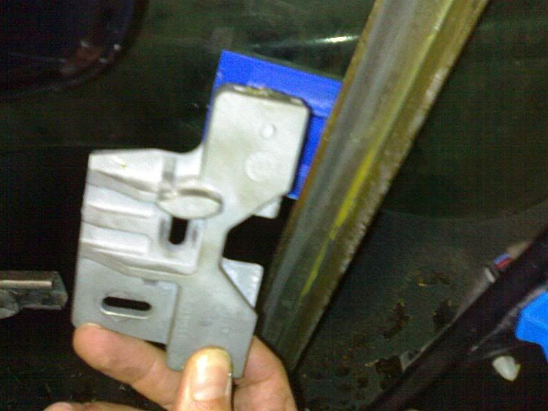

Next remove the 8mm bolt above and lift out the metal bracket.

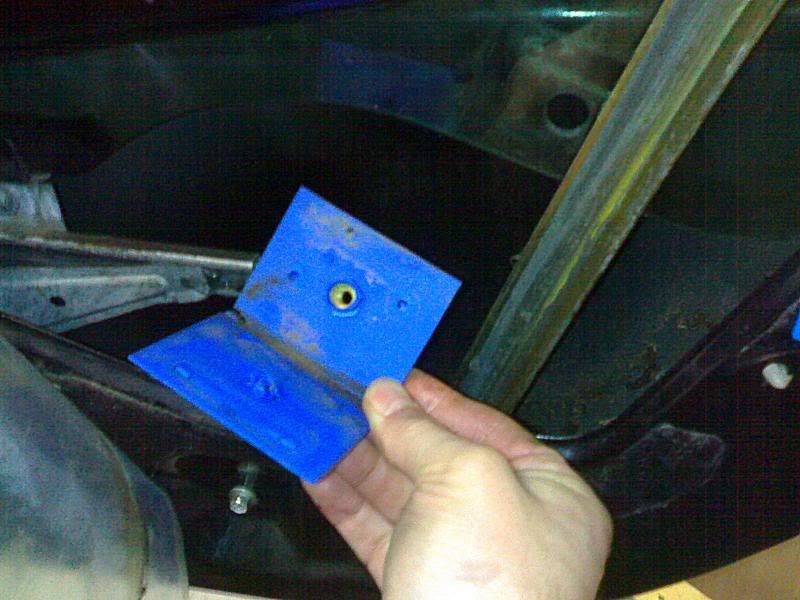

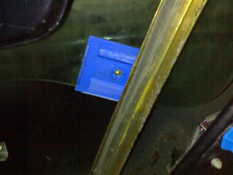

Unfold and remove the plastic packer as below

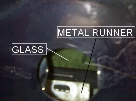

Now make sure the window is closed, then looking through the metal cut outs along the top of the door, you will see the 2, 10mm bolts holding the bottom of the glass to the top metal runner, unscrew these to remove the glass from the support – make sure you hold the top of the glass to prevent it falling into the door.

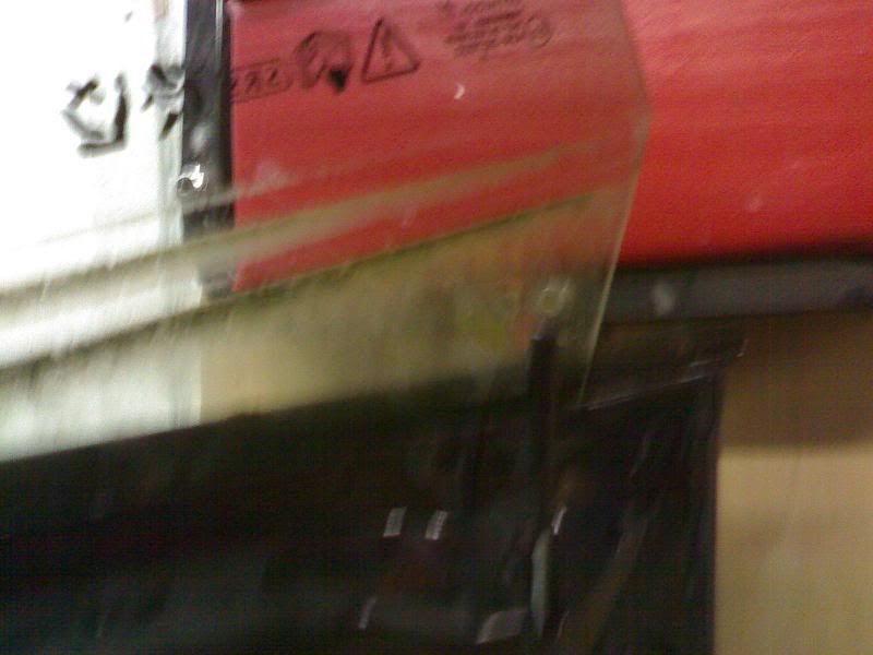

Now lift the rear of the glass up and remove from the door, I left the glass stop on the glass, if you are careful it can be pulled out of the gap in the door. When the glass is removed operate the window to put the regulator in its lowest position (as if the window was open)

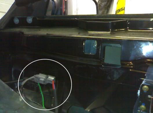

Now the regulator and motor can be removed, first of all disconnect the power supply to the motor, press in the small plastic lever and pull the connector apart.

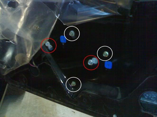

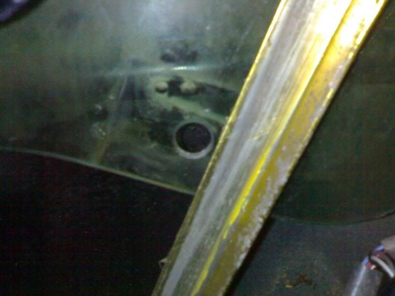

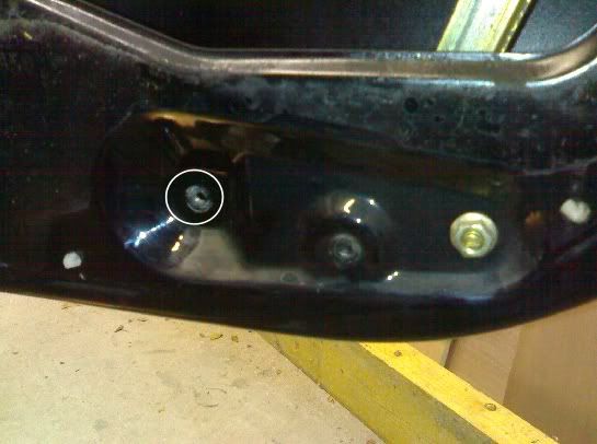

Next, remove the 4, 8mm bolts as shown in the 2 photos below and circled in white. Now loosen only the 2, 10mm bolts circled in red, just enough to pivot the regulator so it can be pulled into the door cavity by hand.

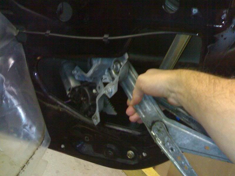

Lift the regulator out as shown.

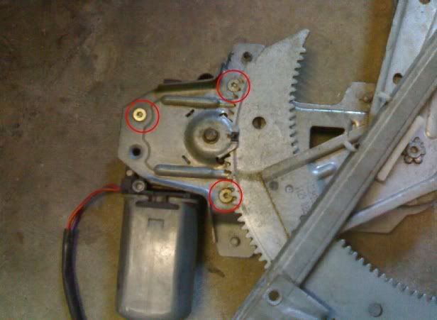

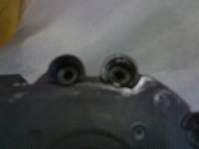

Remove the 3 T20 torx screws circled red in the photo and lift the motor away.

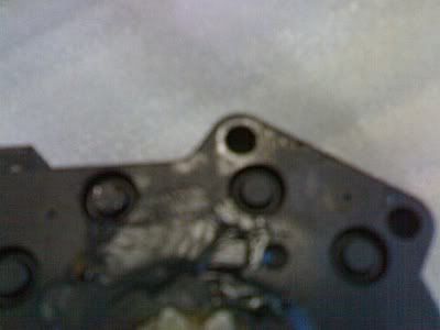

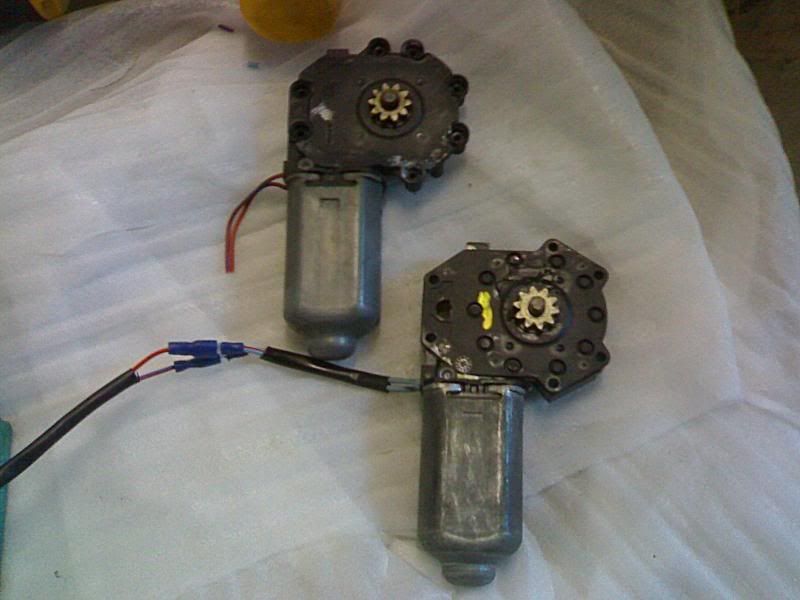

The replacement I obtained (passenger rear door Rover 400 1990-96) has the motor riveted in place – circled in red, drill out the rivets to remove.

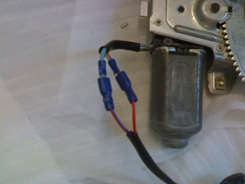

The connector plug was different on the replacement motor so I cut the old one off and jointed it the the new one with spade connectors – this is so I can reverse the connections if the motor goes down when I press the switch to go up!
Here are the 2 motors together (top is MGF) Note that the MGF assembly is counter sunk to accept the indent in the metal bracket, the Rover one is not. Sorry about the blurred photos!
The mounting holes on the Rover motor require slight adjustment with a drill to line up correctly and you either have to counter sink the plastic of the motor or as I did, grind off the indents in the metal bracket so the motor sits flush. Attach the motor to the bracket with suitable nuts/bolts.
