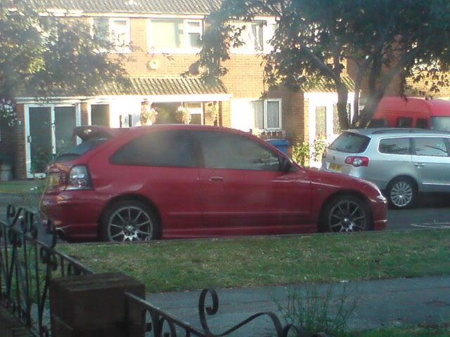

hi mate i have a pic but not sure how to upload it lol its ezactly the same as ( hip stars ) down below but mine has diff alloys and blacked out windows :)
and i love in medway! cheers
