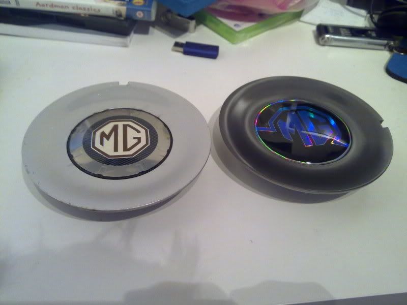

Hi MG ZR women, is it a tool to remove the locking nut or to remove the cover that goes over the wheel nuts?
the cover being this:
If it is just to remove the cover, then I just use my house key in the small square slot and pull it out with that :)
If it is a locking nut removal key, then each keys different (depending on the brand / shape of the nut etc), are you sure you dont have one in the spare wheel footwell ( or underneath the boot carpet, which is where I first found mine ) ?
If not, have a look on the locking nut to see if there is anyway to identify it or take a picture? :) Failing that then maybe try to find a local mg rover garage that might have a full set of keys and could tell you which key you need ( provided it is a mg rover locking nut)
