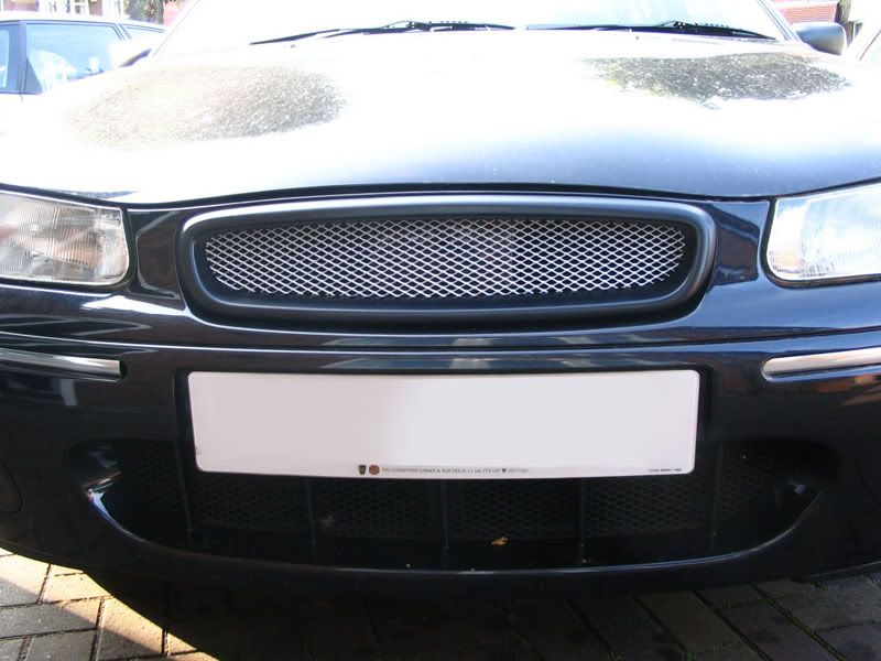

well after a busy week i finally managed to fit and spray my new smoothed grille bak onto the car...!
wot u think??
im well pleased with the result seeing as its the first time i have ever done anything like this! thanks guys for helpin me out...u know who u are ;)
its the first time i did anything like this so i was a bit wary. but its really not that bad if u take ur time and pace urself...
its all about p38 for me...cut out the middle badge with saw and then sand down the rough edges...use filling mesh and p38 to fill the gap...sand and smooth...then primer and paint...job done!
cheers mate..!
next on the list: smoothing the boot handle, meshing the bottom grille and de-oranging the indicators!
has anyone ever sprayed their mesh black or have any pics of black mesh? im considering goin for a stealth look so i'd like to see wot it looks like...photoshop doesnt give me a good idea unfortunatly...
ERm, Sie has some pics around somewhere, he has black mesh, so does Steve.

lol...dude! i was lookin at it 2day and was thinkin how the hell did rover get away with using such crap mesh..! ill giv sie a buzz later see if he still got those pics...!

well havent i been a busy boy 2day...woke up early...done my chores and decided to do a couple more things to the front...have a look and tell me wot u think...i think its slowly comin 2gether nicely!
meshed bumper top and bottom
Finally de-oranged the headlights (what a bitch this was!)
final result:
and another angle:
and also took the 200 off the back:
what u think guys? cheers for the tutorial for the lights by the way mike...it worked a treat!

Looking very nice there Hincey mate. Just looking at the grill surround. Did you laquer the paint, seems a bit dull compared to the other paintwork on the body?
yeh man i did two coats of halfords lacquer but it was crap! didnt even bring any shine up...i put it on for now for the sake of it...but to be hoenst, its not the best job in the world...is there any other lacquers that'll bring it to its shine?? or is it all down to the paint work?
Actually the Halfords laquer is pretty good. I've managed to get some pretty good finishes with it.
The key is to have a hairdryer handy. Cure each coat with the hairdryer and it will dry to a nice smooth finish. On the final coat dry with the hairdryer until you get a mirror finish.
I always get a much better finish than without the use of a hairdryer.
hmmm well to be honest it was the first time i ever sprayed anything on a car. i will redo it one day wehn i have the patience to wait for paint to dry lol...mite give it one more coat of lacquer and see what happens. the final coat of paint was quite matt, do u think this has anything to do with it?
