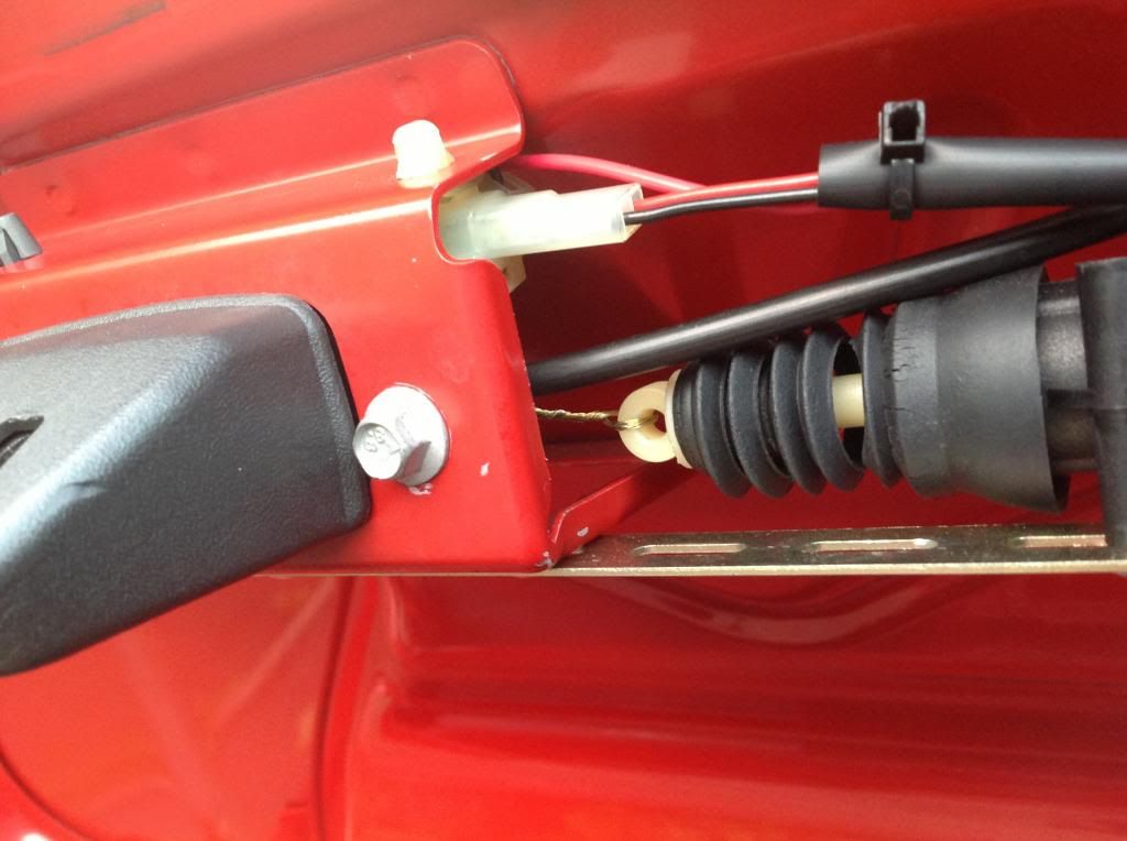

I used picture wire,available in your local DIY/handyman store,and used a stripped an electrical wire connector to hold it together,I'll see if I can get a picture in a mo ;)
#4 ·
I used steel wire off an old bicycle, the wire you use for the brakes.
You can just see it over there:
