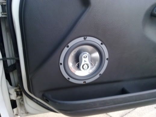

And as said above, dont be an idiot (like me) and remove the speaker cover from the door card (unless you have custom covers with the speakers).
Although, I do prefer the look of the speakers than the cover, so fitted my speakers to the door card itself!:hysteria:
