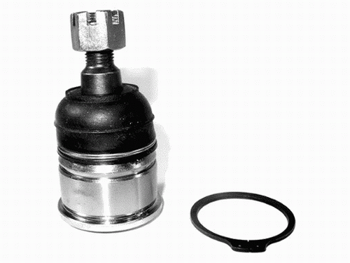

One question to ask though, is does anyone elses bottom ball joints not have a circlip on? Mine never had circlips originally and there was nowhere to fit one on the car even though the new joints came supplied with them. Are there two types of bottom arm? Mine don't seem to have had an issue with the circlips at least but I just wondered if anyone else has the same type?

Have to ask are you sure you are looking the right place, the circlip goes under the boot, haven't seen any that didn't have them but then only seen a few.
Yes I know there should be a circlip, but my car never had one fitted to the originals when I removed them and when I replaced them I didn't fit one either and they all stayed put etc. I'm just confused as to if anyone else has had that issue?
Don't all the joints now have nyloc nuts. I've not seen a castellated nut in ages!
A nyloc nut with a ball joint or track rod end is usually a sign of cheap and nasty parts.
All the Lemförder parts I've seen have had the proper castellated nut and split pin setup.
the lemforder i just put on had this funny oval shaped nut that wouldnt go onto the thread properly so i was forced to use the old nut because the balljoint just kept spinning instead of tightening up
Dunno all of the ones I've seen looked like this:
And does the circlip fit around the top groove? That is where I assumed it would fit but there was no room on my car when they were fitted.
